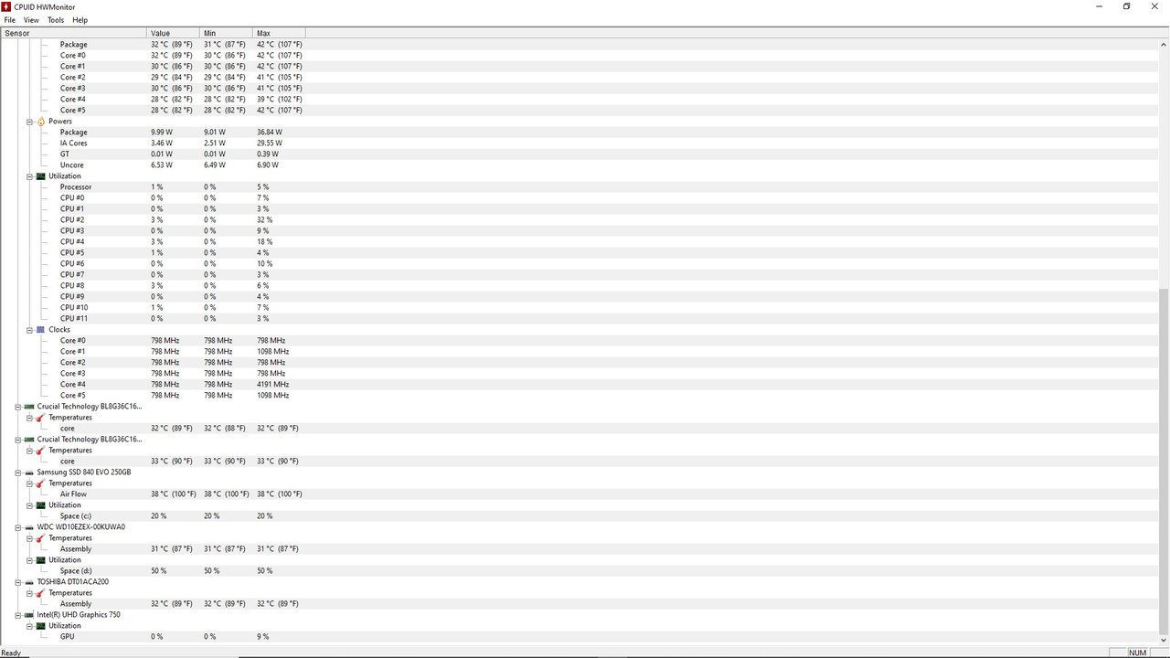

this is my current temp:
to be honest, everything seems the same, only difference i have noticed is the airflow gone down by 2 degree. when at standard mode( not the cpu fan) airflow was at 40 c but with full fans, airflow is 38 c.
many thanks
the 38°C "Air Flow" indicator shown is the temperature of your 840 EVO SSD.
while 40°C is not ideal, it's not a dangerous temp or anything to really worry about.
