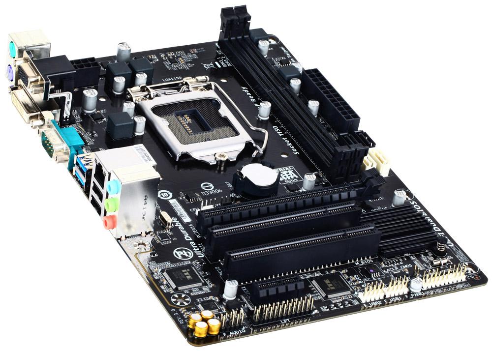

2nd Question, Where would i put it?
I have a h81m - s2pv
If i put it here (1st slot closest to cpu)
would it interfere with the audio stuff or am i wrong about it? im fairly new to pcs
and if it interferes, could i be able to just put it here? (2nd slot closest to cpu)
Keep in mind that im trying to put in a graphics card that is relatively small, id say mid sized

1. Yes that is correct, this card needs no Power Input from the PSU. The power from the PCI Express 16x alone is enough.
2. You should put it in the first and ONLY PCI Express 16x slot of your motherboard.
3. No, it will not interfere with the audio, it should be perfectly fine. Should there be any issues, either you A) did something wrong, or B) your motherboard or gfx card is faulty.
4. No, you cannot put it in the 2nd slot, as that is an old PCI slot and should only be used for old cards like network cards, sound cards etc that require a PCI slot.
PCI and PCI Express are not cross-compatible. You cannot put a PCIe (PCI Express) card in a PCI slot, and vice versa. It simply will not fit, so its even foolproof. Should you somehow...
PCI and PCI Express are not cross-compatible. You cannot put a PCIe (PCI Express) card in a PCI slot, and vice versa. It simply will not fit, so its even foolproof. Should you somehow manage to stick the graphics card in the 2nd (PCI) slot, then it will either damage the card, the motherboard, or both.
