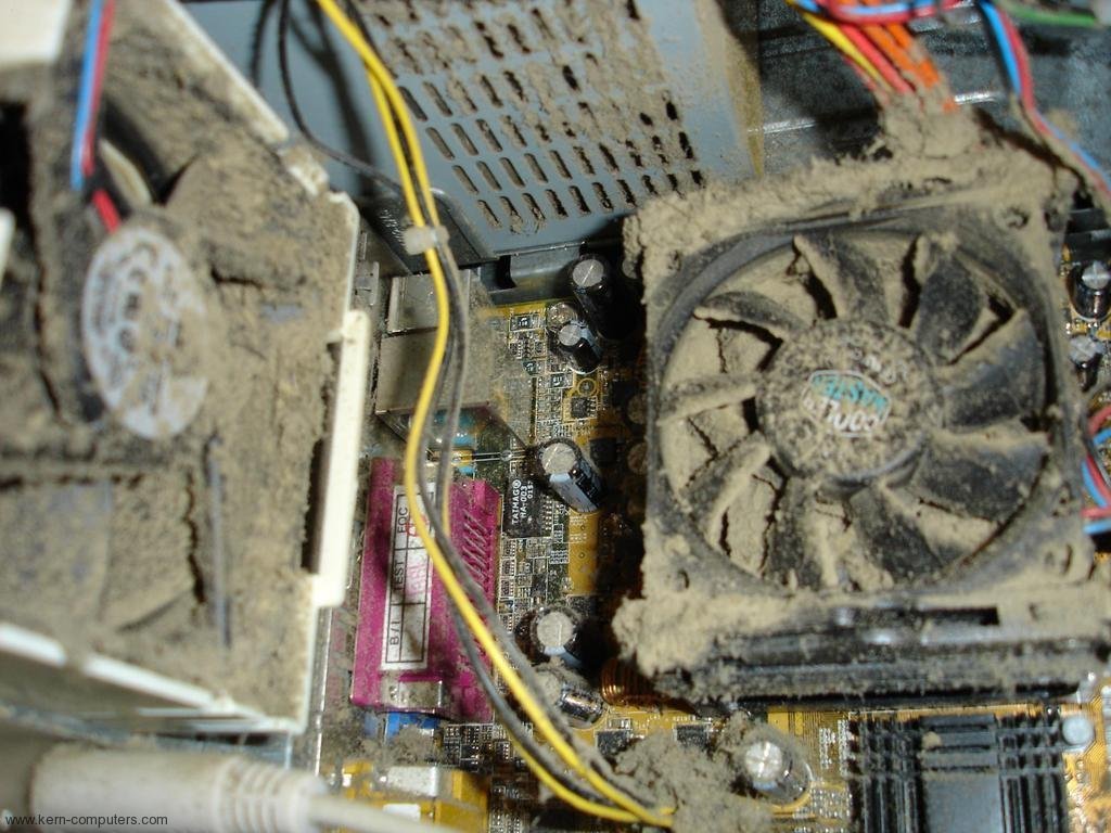

Yet another computer damaged by "cleaning". I don't understand the logic behind removing a thin layer of dust, until it gets really bad. As the old saying goes, "If it ain't broke, don't fix it".
