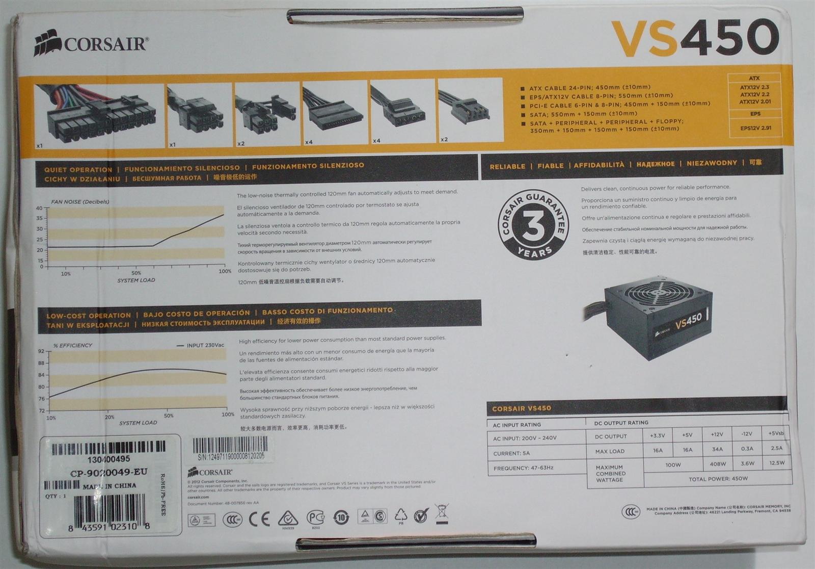

Yes mate atx 12v.
You should have 2 blocks of 4 12v connectors coming from the PSU on their own cable.
These may be clipped to together to form an 8 pin but will disconnect to form 2 x 4 pins.
2nd from left in the picture
Only one of these will fit & only one way round so its impossible to plug in wrong.
