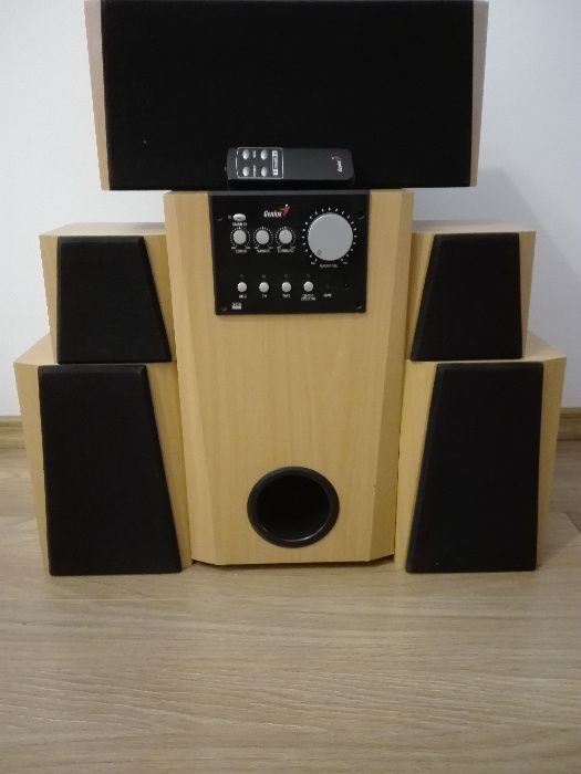

But before calling the guy who repaired my system, I thought of replacing my sound card because, who knows, maybe it was the card's fault. So I took out my sound card and replaced it with my previous one, a Creative Audigy SE SB0570. And after that, I restarted my PC and since Winamp wasn't working, I reinstalled the very same sound drivers, and now everything sounds OK.
So what happened? Has my Xtreme Fidelity card really malfunctioned? If so, why? I mean, usually sound cards don't get ruined as quickly/easily as video cards, right?
I also have to mention that after the repair of my sound system Genius, every once in a while the speakers made a small sound, like a hissing or something like that. And I don't remember them making this hissing before, only after the repair. What happened? Has the repair of the Genius system affected the sound card?
Is there any point in inserting back my Xtreme Fidelity card to see if the problem is still there? because in that case I can be 100% sure that it's the sound card's fault, right?

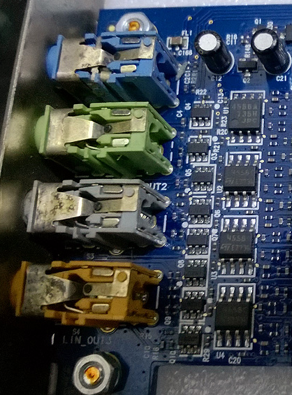

PS: I noticed that the orange connector was the issue with my Xtreme Fidelity card, I mean after the sound malfunctioned, if I took the orange connector out of the orange slot of the card, the weird noises stopped. And when I plugged it back in, the weird noises started again.
This is the orange connector, the one at the bottom:
4-png.301267
What do you think? Is there any point in reinstalling the Xtreme Fidelity to see of the problem persists, or it's just a waste of time and I can throw away the card?
From the two pictures it doesn't look like there is anything obviously blown on the card. There is a fair bit of corrosion on the ports, and it's worst on the orange one which could also be the source of the issue. I'm not sure how easy those would be to get at depending on how they're attached to the board. It sounds like a physical issue rather than a software issue and while the hardware itself might not be faulty it may also not be worth the time to diagnose.
Generally speaking anything feedback wise through speakers is going to be a connection issue.
OK, so what do I need to do? What can I do in this situation? I really love my card and I don't wanna just throw it away, if it can be fixed somehow. Should I try cleaning the orange connector somehow, for example with cotton and alcohol? And then insert the card again and see if the problem persists?
What should I do to solve this problem?
You should give that a try in case it is some sort of build up as it won't hurt anything, but I doubt that will resolve it. If it is due to corrosion that will not fix it replacing the entire 3.5mm jack is what would need to be done.

I shall just add the oxidation on the connections looks normal for a card of that age and I wouldn't be that concerned about unless it was starting to turning green.

You could take the card out and give the inputs a good soaking in switch cleaner or cleaning alcohol while carefully using a soft tooth brush giving them a lite scrub.
But they don't look that bad to me just aged, a clean wont harm them if your gentle.
