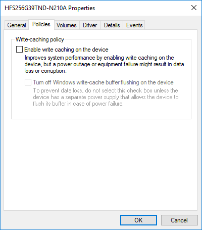

But after reboot all partitions and data disappear. Right?
So disk writes are being cached and do not get saved to the drive.
Try disabling write caching to the drive.
We're getting close
Partitioned SSD, copied a 8 Gb movie, watchable
Rebooted, still there, still working
So I shutdown and it disappears again.
I reformat it, do as advised 'disabling write caching to the drive' and...
It disappeared from BIOS. And computer wont turn on while its connected(10 minutes on the Gigabyte logo). Connecting after computer is on(both SSD and mobo support hotplug) doesnt show anything.
