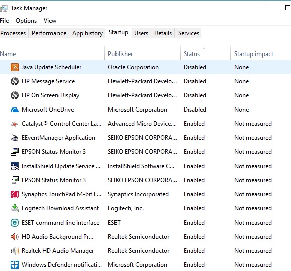

To confirm this idea, search Task Manager Processes for any of the "not measured" items.
Hello and Thanks for the help.
I looked at the not measured items under the process tab. Not sure what I am looking for. Some of the not measured are not there at all or are maybe hidden?
That said when start up was working correctly..... if memory serves me right most were low, I think one was high....but I could not say which one(s).
I tried another disable/ enable again and still no go.
3 more shots of processes. I hope they add in.

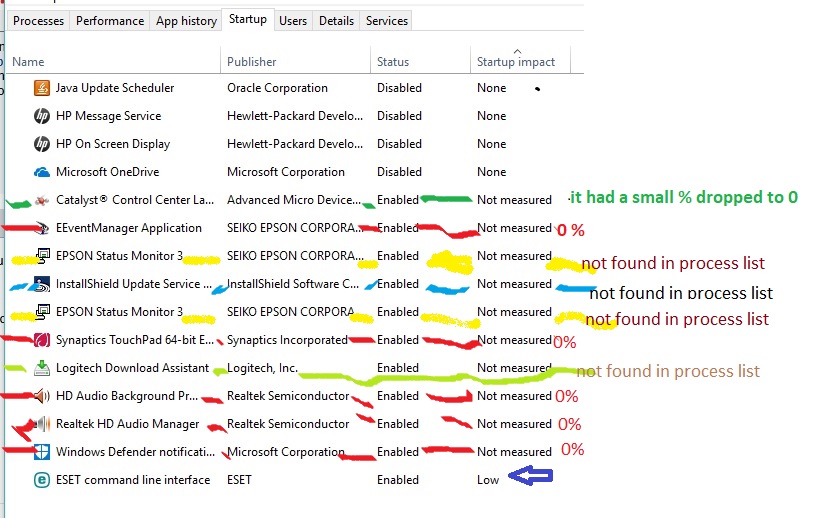

UPDATE:
Hi Is it possible that some of these things do not always have start up impact? I know for sure one item was always high impact, and the rest were probably low?? (again from memory) Now the only one measured is Eset as low. It seems strange for it to change. When I did the CHKDSK C: /f & the disk clean up it had a very large amount of space to delete & took about an hour to clean out.
Here is updated list you asked for 4 items I can not even find in the process list Thank You

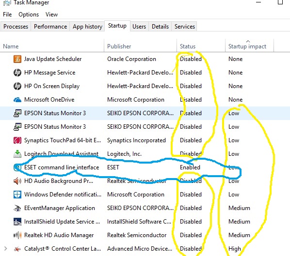

Hi Peter
You can not disable Eset in the Start UP tab, so I went to the Eset settings and paused it for 10 minutes and did a restart. It DID automatically turn itself back on and was live. But now in the start up, Eset is now not measured, a few minutes before I did this it had LOW impact?? getting stranger all the time... a real mystery?
Okay this is really weird now. After I tried to stop ESET temporarily through settings, but remember it automatically comes on at restart. I went to task manger, start up tab, and disabled everything but Eset (as it can not be disabled here) and did a restart. Low and behold......ALL but Eset are disabled, but all are showing start up impact??? How does that happen?? see pic

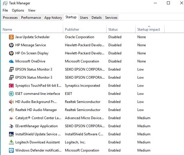

UPDATE: well a bit later ALL except Eset show disabled,(as it was bit earlier) and now the only one reading start up impact is Eset at low, the rest went back to not measured. this happened all in about a one hour time frame. So it now looks different than the photo I posted What the heck is going on here??? have I got a haunted computer LOL!!
UPDATE 2: Well about 5 or 6 hours after the above update I checked start up and got this? It seems to change on its' own. I don't know how or why?
https://i.postimg.cc/76DH3Vf5/process-at-midnight-works.jpg
Still the same this morning 5 medium, 6 low, & 4 none.

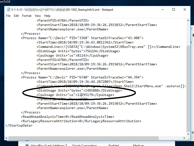

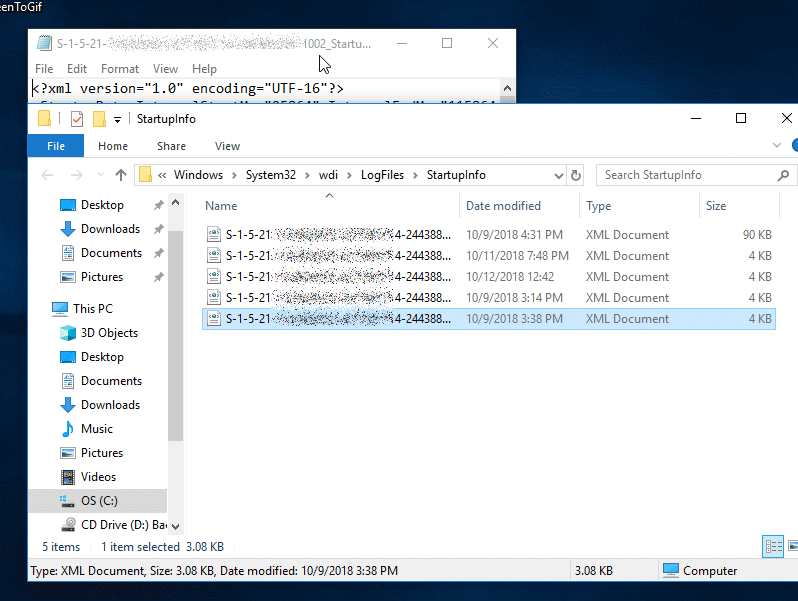

This thread interested me so I went into my test system to try to figure out where the info comes from. I wouldn't recommend doing what I did below. I have a system setup that I can destroy and not have to worry about it. I'm sure you don't want to harm yours.
Start of Not Recommended
Using info from the link that Syix_KD provided above, I went into the C:\Windows\System32\wdi\LogFiles folder and opened up the StartupInfo folder within and looked at the log files. In the log files, you can find info about the Hard drive usage and CPU usage for each of the startup programs, which is calculated up to determine the "Startup Impact". I edited the info for Open-Shell to see if the Startup Impact was changed in Task Manager and it was.

Now you now know where the info is taken from. The question is, why is yours being reset? There's probably several possible answers to this.
Maybe it's some type of automatically running Disk Cleanup software that you may have installed deleting the log files. It could be ESET. It could be some type of "privacy" utility. If you have any such software installed, disable it for a few days to see if that helps.
Maybe it's a disk going bad. It's unlikely, but you could try running CrystalDiskInfo.
Maybe something else. I'm just guessing but I would think it's a 3rd party (non-Microsoft) program that you are using.
