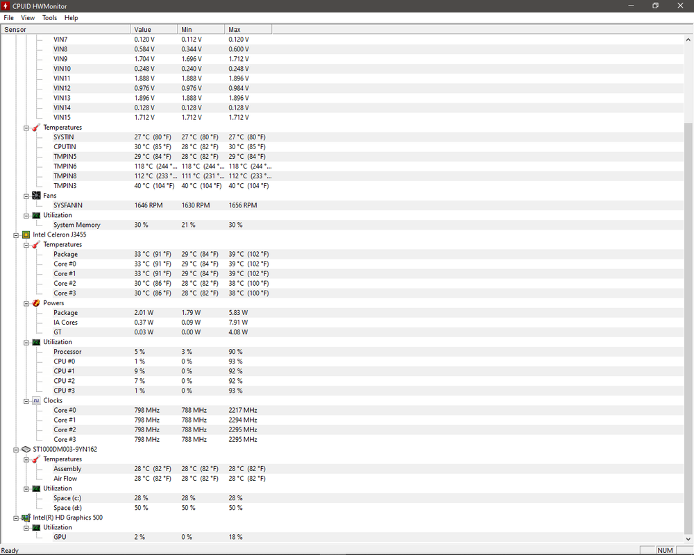

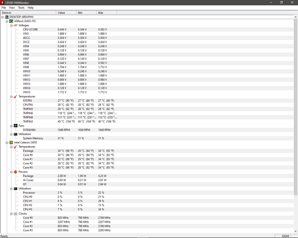

I've installed a few temperature monitors on the PC including HWMonitor and a few others that really did not work very well. I have not really noticed any super high temps in the setup over the course of time that I've monitored this (about 2 weeks).
You can see my readings with HWM below:
...AND:
Things I have done to rectify this:
  • Monitor the temps in the unit with various programs as reported above there were really no super high findings. The worst I think it got was about 120F.

Ok when I had looked at those readings before shutting the PC off for a few hours it showed that the mobo was really hot, so I went on ahead and took the screen shots using the program you suggested. Could these high mobo readings be an issue? These screen shots below are done cold
Darkbreeze
Ok, sorry, but you're going to need to do it again. And by "idle", for the purpose of what we can reasonable CALL "idle", you don't need it to be "cold". Just start up HWinfo, then let the system sit for about two or three minutes, with no other open/running applications. Take a set of screenshots.
Then, run something demanding like Prime95, Furmark, or even Photoshop with a large high resolution image and Chrome/Firefox with a bunch of tabs open and some videos playing, some kind of encoding program like Handbrake, something to put the system under a fair amount of stress, and then take a second set of the same screenshots showing the system temperatures and also the system voltages. It might take several screenshots to capture all the sensor values.
The reason I want you to do it again, is that I want you to go into the options on HWinfo, first, and change it from F to C. Everything on the PC should be done in Celcius and your screenshots are showing Fahrenheit, which makes things look much worse than they are because Fahrenheit readings actually translate to much lower Celcius readings. Translating is problematic though, and time consuming. Everything in the thermal specifications will be in Celcius so lets get accurate screenshots and go from there.
You can change it to Celcius by opening HWinfo, run Sensors only, click on the button that looks like a gear (settings) in the lower right bottom of the HWinfo window and on the "General" tab change the temperature fields radio button to Celcius. Save and exit the settings window. Restart HWinfo and you should accurately be showing Celcius now.
