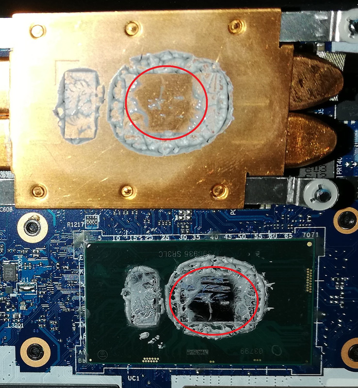

I repasted my Lenovo E480 for the first time earlier on this year using "Cooler Master Mastergel Pro V2 " paste.
I could immediately see a huge speed increase, which was unbelievable.
A couple of months later though, my PC started running slow again and I had to crack my laptop open again!
When removing the cooling system, I was surprised to find an oily residual atop the processor (surrounded by some left over paste).
I though I might have not applied enough paste the first time around and I therefore applied a new slightly thicker layer of paste (after thorough cleaning of course).
Not even a couple of months later, here I am again with my PC getting sluggish!
Am I doing something wrong?
If not, what could be problem? Could it be that the heatsink needs replacement? I am wondering if the heat may have damaged it. Maybe it is not anymore perfectly flat (although I cannot tell by eye), preventing the paste to be homogeneously applied onto the processor.
Is this specific paste the problem? Should I use something else instead?

Jun 10, 2021
8
@geofelt and @iPeekYou, I have added a picture in my description.
What do you think about the "sweaty" part in the middle of the processor?
I understand I put too much paste, but why is there nothing left in the middle a month after applying fresh paste?
geofelt
I am more familiar with desktop coolers than laptop chips and coolers.
It looks to me that the mating surfaces are not smooth and do not meet really well.
But, I would not worry much since the absence of paste in the center says that the parts there are close to metal to metal contact.
That is good.
If you look closely, you can see a few rivers and pits which have been filled in with paste.
That is exactly what paste is designed to do.
If you are inclined to repaste, buy a good brand name paste. I use as5 ,mx4, or nh1 which comes with noctua coolers.
Opinions vary but differences in cooling may amount to a difference of 2c. or so.
Reactions: junkhardware
InvalidError
That is good.
Unless the reason there is almost nothing left is because the thermal paste was too runny and ended up pumping all of the particles out of the interface such that only oil got left behind. This "gel" probably has too low viscosity to hold its particles in place.
Reactions: Phaaze88
InvalidError
@InvalidError, so are you saying this brand is probably bad after all?
Could the heatsink be too tight or damaged/curved due to the heat?
Not necessarily bad, just apparently not appropriate for your specific application. Depending on how long the paste may have been sitting around, the reason it may have come out runnier than it is probably supposed to could be that it sat around long enough for a good part of solids to separate and not come out evenly, so you ended up getting more oil than anything else.
You would need temperatures well in excess of 100C to damage a heatsink and the CPU will trigger a thermal shutdown long before the heatsink gets anywhere near that hot, so heat damage to the heatsink shouldn't be a thing except for its plastic components if applicable.
geofelt
Oily separation smacks of old stock that has separated.
Good paste is cheap enough, and I agree that a new paste would be a good thing to try.
Too tight could be a problem if it warped the cooler or the base.
Uneven tightening could cause that.
