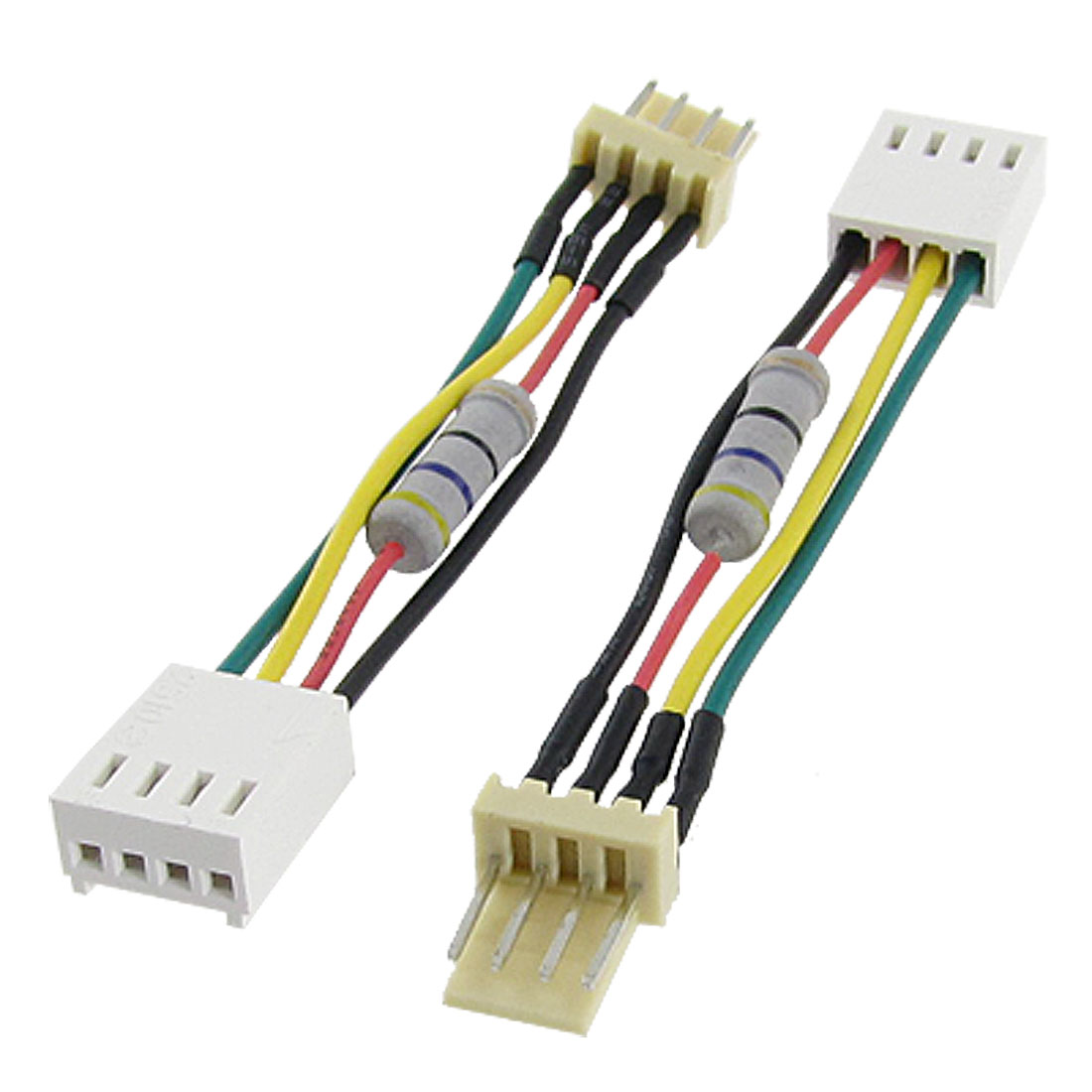

I remembered I have a few fan voltage reducers so I figured I'd bare one to see it's setup. A simple in-line resistor (appears to be 1/2W 51Ω on my 12v-7v reducer) like this
1663268
image (and corresponding thread) found here http://www.overclock.net/t/1427454/the-weird-4pin-adapter-that-comes-with-bitfenix-fans-is-it-safe I'll suggest reading it
its not about voltage... its the current flow that will be reduced thus reducing fan rpm. 51 ohm seem to big. but ill try different values, 20 ohm up to 51 ohm. [[ but the pic above is 47 ohm ]]
