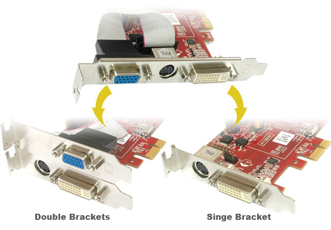

Your computer needs low profile card like this on the right side of the picture or the double singles on the left:
200901021210245855jpg
Yea thats probably why, dont know why i diddent think about it.
I already found a good looking and cheap case. Although a bit sad, I really do appreciate how fast you responded! I was expecting about a week for an answer, but instead took a few hours. Thx for tips!
