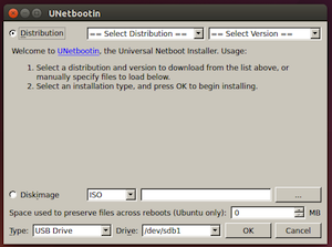

Download this iso to use:
https://www.spi.dod.mil/docs/TENS-3.0.1_public_deluxe.iso
