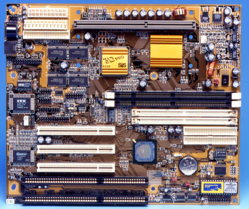

I have an old computer next to me here that I have promised to upgrade a little. Before anyone say anything about buying new stuff, I really have the time to do this and I have some spare parts around to upgrade the computer (basically a bigger harddrive and install Xubuntu).
I am a Norwegian that has moved to Brazil and a lot of people here still has old computers that work ok. This one has Windows 98 on a 3 GB harddrive. It has had some problems with the powersupply and when I attached it to the power in our house, I forgot to set it to 220V instead of 110... Powersupply do not work any more :-( So if I can not fix it, I need to get a new/old/used powersupply.
Well, I might be able to use a standard ATX if it fits the board. The problem is that I do not know what board it is. I have been searching all over it to find the name, but all I can find is a version number saying V1.1A and that does not help me a lot... Here are the things I can see on the motherboard:
It is has a Celeron processor type P2 or P3 where the processor is on a riser card.
It has the old type keyboard connector (not PS2)
It has no other connectors on the board, only headers that are connected to plugs.
It has 3 PCI and 2 ISA (one might be shared - I do not know)
It has two different powerconnectors. The one that was connected to the powersupply was one I had never seen before. My hope is that the other one is able to connect to a standard ATX powersupply.
It has an AMI BIOS
There is an Intel chip onboard, maybe the PCI controller?
There is an SIS chip onboard, probably the graphics controller
Another chip marked i440 EX/LX is on the board
There a four RAM slots, two for an old type of RAM and two for a newer type. I am not sure if all can be used at the same time, but I have a few of the older type around, so I am going to try as soon as I have power back.
It would of course be easier to use software to detect all this info, but as the powersupply is not working, this option is not available...
If anyone know this board and can provide a link to a manual in PDF form, I would be very happy. The people that will use this computer are only going to use it to check e-mail once per week and maybe check a website or two. So if I can get it to work, it will server them well for another couple of years!

I am sorry, no. That is why I am posting here. I can not find any info besides the version number close to the power connector.
My hope is that the very knowledgeable people in this forum will be able to recognize the board and provide me with some info.

Yes the Celeron came in Slot1, they started iirc at 233mhz, 266Mhz and 300Mhz but had NO L2 cache. Then came the wonderous Celeron 300a which was the first Intel chip (excluding the P6) to have on die cache, most 300a's clocked to 450 (66 FSB to 100FSB) but the LX chipset would only officially do 66mhz. @ 450Mhz the 300a was faster than the P2 450!
iirc you cannot use dimms and simms as the voltage is different.
It would appear that the board may be able to use an atx psu.
Somewhere on the board should be a Mxxx number, if not you are just going to have to fire it up and it will be shown on the first bios page.

you have brought back some old memories! I remember me and my dad building and selling sooooo many computers with those motherboards! It is an sis 6326 video with 8 meg or 4 meg of onboard mem, the sound is a cmedia sound pro sound cm8330 chip. It was a p2 mb i don't think it could do 100 mhz fsb but i could be wrong. And you can use both the sim and the sdram 66mhz ram at the sametime with out hurting it did it all the time. And you can use either and At or atx powersupply. i have the old driver disc for it but it is super scratched and barely reads. I hope that was some help
Well, I got it to start after connecting an old ATX powersupply and clearing the BIOS. However, it did not give any message about what brand or type of motherboard it is. So I am going to try with a Linux disc to see if I can get it to boot and check some things.

a MOBO MANUAL would be helpful for jumpers etc - too rare, good luck.
yeah, took a fair amount of search attempts, used Pcchips "discontinued manual" into google 😀
PCCHIPs are still about, but there doesn't seem to be a direct link to old products on their web sites.
