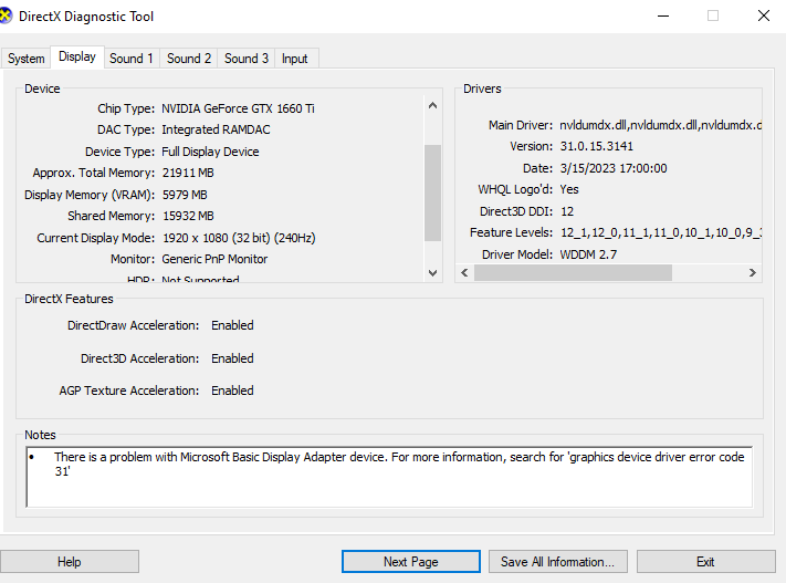

Bios is 1.18. DIMMS are installed good(1 is at the edge of motherboard, then 1 space and 2nd one.)
Maybe i should test with 1 stick ? the plastic of ram was cracked on delivery but the sticks didnt look damaged or touched.
The game im trying to play i have constant 600 FPS, up to 700/800, so 4800 or 6000 ram is irrelevant for me, i think, but everything else crashing is annoying and makes me wonder where is the problem ?
directx diagnostic tool:
https://ibb.co/nB5y6X8
https://ibb.co/jZdphBj
https://ibb.co/k5tkk2P
Rest of the specs:
Operating System: Windows 10 Pro 64-bit (10.0, Build 19044)
650W GOLD 80+ be quiet https://www.mindfactory.de/product_...Pure-Power-12-M-Modular-80--Gold_1480492.html
GPU: ZOTAC 1660 TI 6GB
Cooler: BE QUIET PURE ROCK 2 150W
AMD Ryzen 5 7600X 6x 4.70GHz So.AM5 WOF
4TB Seagate IronWolf ST4000VN006 3.5"
ASRock B650 Phantom Gaming Lightning So.AM5 retail
1TB Samsung SSD 980 M.2 PCIe 3.0 x4 3D-NAND TLC
