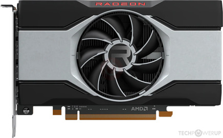

My son is complaining that his games are lagging and that his computer is too slow. At the time we cannot afford to buy him a new PC. I am considering upgrading his PC to be fast enough so he can play his games., either with a new CPU or GPU.
He currently has:
- Motherboard: MS Star MS-7bs8 (1151 socket)
- Intel i5-8400 CPU 2.8 GHz CPU mark 9256 according to cpubenchmark.net
- AMD RADEON RX 6500 XT 4GB memory
- 16GB of RAM
If I upgrade his CPU to this one:
Intel CORE-I5-13400F his CPU mark will rise to 25278, almost three times faster.
I have read a few articles about his graphics card which say it still is quite good. But if I upgrade to RAMD RADEON RX 6600, the performance will rise by 69%
1. So what is best to upgrade, CPU or GPU?
2. And if upgrading the CPU is best, can I buy any CPU as long as it uses the same socket? I'm thinking about heat and power consumption.

A video card would be my suggestion for a performance upgrade on a budget. The 6500xt. is entry level and only 4x pcie slot connection for data. and 4 gig of memory@64bit really cripples it.
It would perform a little better on a newer board, but not worth the cost.
If budget allows a 6700 is a much better buy.
It will last a couple years longer @ playable frame rates. And get a performance boost with a platform upgrade later!
