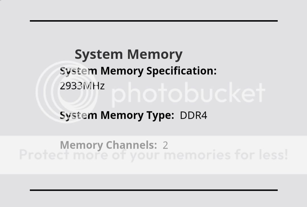

I bought the 3200 after reading the CPU max is 2933 (Ryzen 7 2700), and just looking at the Ryzen 7 2700x stats since I changed, the specs are the same- see here. I'm not sure what the potential/ability/max for overclocking is.
Here is exactly that I bought. I only bought it two weeks ago so I can change. I figured I'd try OC'ing the RAM, so what would I be best doing- staying with what I have, swapping for 3200 4x8GB, or going to either 3466 or 3600?

I was wanting 4 sticks of RAM (like you said, eye candy), but I was told what seems like the opposite of what you mention (unless they were talking about the controller like you said), but I remember it being something like 'it reads the memory faster only having two sticks to go through instead of four, including single vs dual sided.'
Although performance wise I probably won't notice a difference going to 32GB of RAM couldn't I add two more sticks as long as the timings matched (same brand/item)?
When RAM DIMMs are made, they are tested with each other and those sticks that get along well are put into sets. First set to be made is the set of 8 RAM sticks and sold as 8x RAM sticks in a set. If the set of 8 doesn't work, it's divided into half which makes up two sets of 4. If the 4x RAM sticks do work together, the are sold as 4x RAM sticks in a set. But if the set of 4 doesn't work, it's again divided into half, making two sets of 2. Two RAM sticks that work well with each other are sold as 2x RAM sticks in a set. Those RAM sticks that doesn't want to work together at all are sold as single RAM sticks.
Due to that, you have a risk of getting two identical RAM sets working with each other. Even i had that risk when i bought my 2nd set of Kingston Savage RAM. But since i specifically looked for my MoBo memory QVL and pick the specific RAM that MSI has tested and confirmed that it works in all 4x slots, i had all the assurance i needed.
Here's further reading about mixing RAM and it's issues, link: https://forums.tomshardware.com/faq/troubleshooting-problems-with-pc-memory-ram-and-xmp-profile-configurations.3398926/
When it comes to the RAM speed, Ryzen chips by default support: 2133 / 2400 /2667 / 2933 Mhz speeds. Meaning that if you buy 3000 Mhz RAM, you can run it in 2933 Mhz. 3200 Mhz RAM does work in 3200 Mhz speeds though.
Also, it isn't worth the money to buy any faster RAM than 3000/3200 Mhz.
