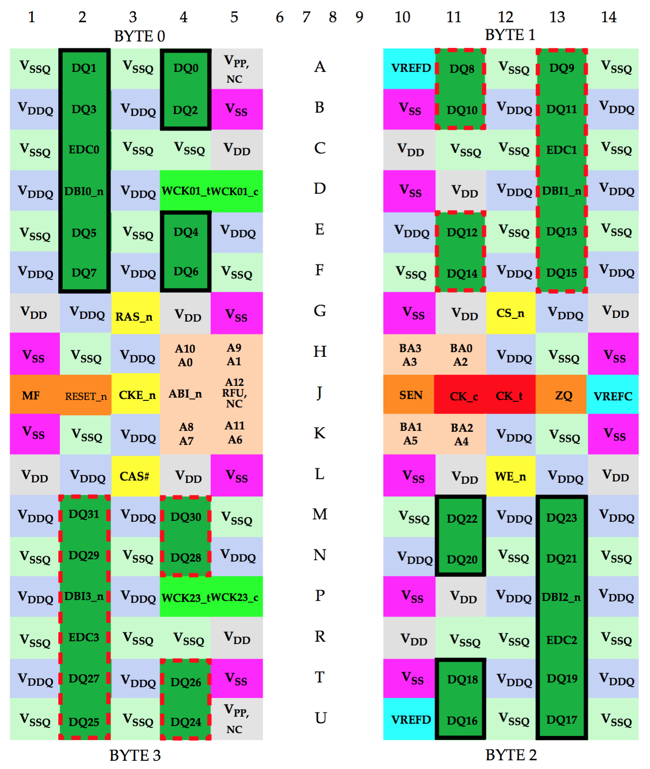

No, you have to use GDDR5. GDDR5X has more pins and is likely incompatible with GDDR5 based layouts to avoid mixing and matching.
EDIT: Confirmed, GDDR5 and GDDR5X have a different pinout (from http://monitorinsider.com/GDDR5X.html)
