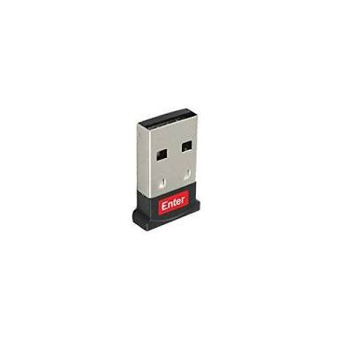

Hiii i am thinking to connect usb bluetooth adapter to a cable with 3.5mm aux to female usb 2.0 and this 3.5mm aux will go into my dvd through mp3 link port.
So basically i want to turn dvd into wireless using this cable and a usb bluetooth adapter will it work...?

Usb bluetooth adapter pic

Non it won't work , you need to buy an actual standalone bluetooth transmitter/receiver that is geared up for audio use.
Those little bluetooth dongles have no controller software onboard which is why they only work with a PC.
It is a touch and go. Main reason is that USB things require voltage to work. Said image has mic, left, right and ground.
3.5mm plug does NOT supply voltage.
Said first plug would possibly work with usb extender cable from computer to dvd player though since computer side would supply the power to USB (and thus the digital/analog conversion that the plug does.)
The big question is, if the aux port is for TRRS (like the plug in 1st image) or just TRS port. If it is TRS port, it is likely that it wont work with said plug at all.
