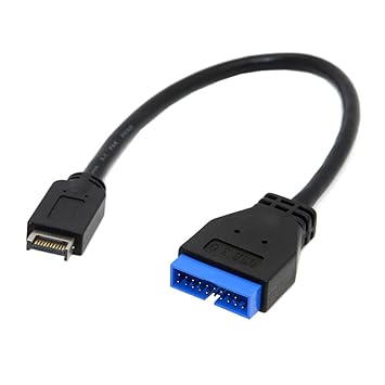

Don't use the one Gen 2 port for now. In the future you should be able to get a cheap adapter, but for now it's too new so adapters are only available to convert the other way:
Note that an adapter won't run at 10Gbit+, or allow you to charge things at 100w like a real Gen 2 port may! But it would provide a usable Type C port at 5Gbit speeds, and the case has a wireless charging pad anyway.
