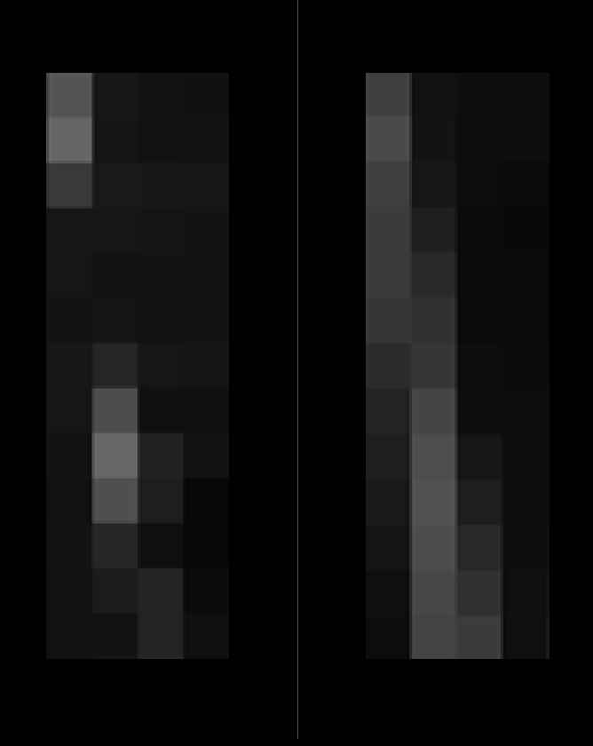

this is a pic of dsr in an extreme closeup
left is normal/right is dsr
you can clearly see it interprets the pixels in a better way from downsampling.
