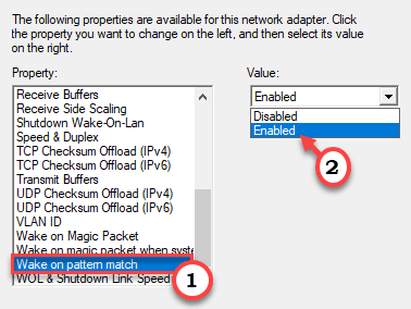

also enable this:
and change WOL and shutdown to 10mbit

also enable this:
