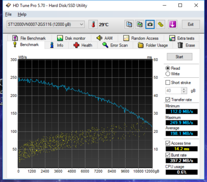

popatim
IIrc, center disk speed drop on those is typically only about 75MB/s but with drives that large, it wouldn't surprise if it has remapped sectors in that area right from the factory.
Wu-Zi-Mu
Feb 20, 2016
28
4
4,535
Drive speed drops off towards the center significantly on all HDDs, 2x dropoff is maybe a little big but 1.5x is typical for much smaller drives.
I reckon it drops off worse than smaller drives of that line because they left less empty space in the center of the platter. They had to fit in 12TB after all
