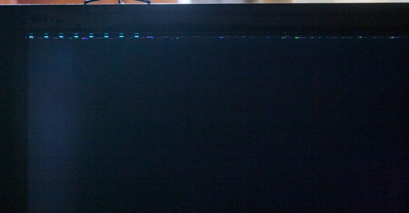

I currently have 2 hard drives in my computer, one of which used to be a USB 2.0 external drive. The internal that I bought when I built my computer wasn't large enough to hold everything I needed it to, so now I use the old external mostly for my Steam/games directory. It does fine for the most part, but every once in a while things just seem to go wrong and the computer will restart. It doesn't actually blue screen, it just restarts. (Sometimes it restarts fine and shows BCCode 109 if I remember correctly.) As it's restarting, I see the normal blueish horizontal lines that appear when you have the 'no GUI boot' option selected, but then some more, weird lines show up behind it that go all the way across the screen. It looks pretty much like this
What I end up having to do is hold the power button until the computer shuts off, remove the hard drive, hook it up via USB, start the computer, and run the windows error check, turn off the computer, re-insert the drive and that seems to solve the problem...until it happens again that is.
I'm close to reformatting one or both of my internal drives, or just buying a new HDD altogether.

What are your specs. This doesn't really look like a hard drive related problem.
Yet, I guess you can start with something simple as just attaching the drive with different cables to a different port.
In case the issue persists, my suggestion would be to take the drive out, attach it to a different system, back all the important data stored on it up and test it with some of these: http://www.tomshardware.co.uk/forum/282651-32-best-diagnostic-testing-utility
I believe you can test your other drive as well.

Hmm, ok. So just get some kind of stress test program? I have a GTX 560ti
Would that be contributing to the problem with my hard drive as well?
EDIT: ran Video Memory Stress test and nothing obvious came up.

I seem to remember trying different SATA ports when I first installed the drive, and the one it's hooked into is the only one that would work.
Also, the drive is formatted as FAT32 since it used to be an external. Not sure if that would cause some kind of issue.
I honestly don't remember the specifics of my specs as it's been a few years since I built it, but it's got
8GB RAM (I think 2 4GB corsair sticks)
i5-2500k (no OC)
GTX 560ti (also no OC)
The problem drive is a Hitachi 1tb
The other drive that has windows and most programs installed is a Seagate barracuda 500gb
I'll try running one of those programs though and see what it says. Thanks.
