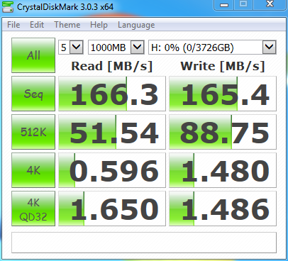

The Seagate's CrystalDiskMark results are pretty bad (the HD Tune ones are not that much apart, though) - however, the Seagate is 93% full whereas the Toshiba is at 14%.
I just did the CrystalDiskMark test on a 95% full Samsung 1TB 7200 HDD and got almost the same results as the Seagate, whereas as far as I remember, when it was empty, those were just a bit worse than the Toshiba's. Can't do another empty test to double check, as I just moved everything back from the WD Blue to that drive, but I'd consider that a factor.
Here is another set of benchmarks of the Seagate:
http://goughlui.com/2014/06/20/4tb-head-to-head-western-digital-green-wd40ezrx-vs-seagate-desktop-st4000dm000/
HD Tune comes to the same conclusion as in your samples (i.e. not that much of a difference), but DiskMark (here on an empty drive), is thus:
It is still slower than the Toshiba, but not by much. Considering the Toshiba is 7200 RPM and the Seagate 5900, the results are not bad (my WD Blue at 5400 had similar results). Basically spindle speed does not seem to be much of a factor these days.
