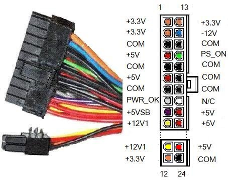

Yes, it's possible something is broken and it still works. That doesn't mean it will function properly under all conditions. As you can see below, there are duplicate pins of each of the voltages (3.3v, 5v, 12v). If one of those lines has a break in it, you will have a problem when the system is demanding high power levels.
