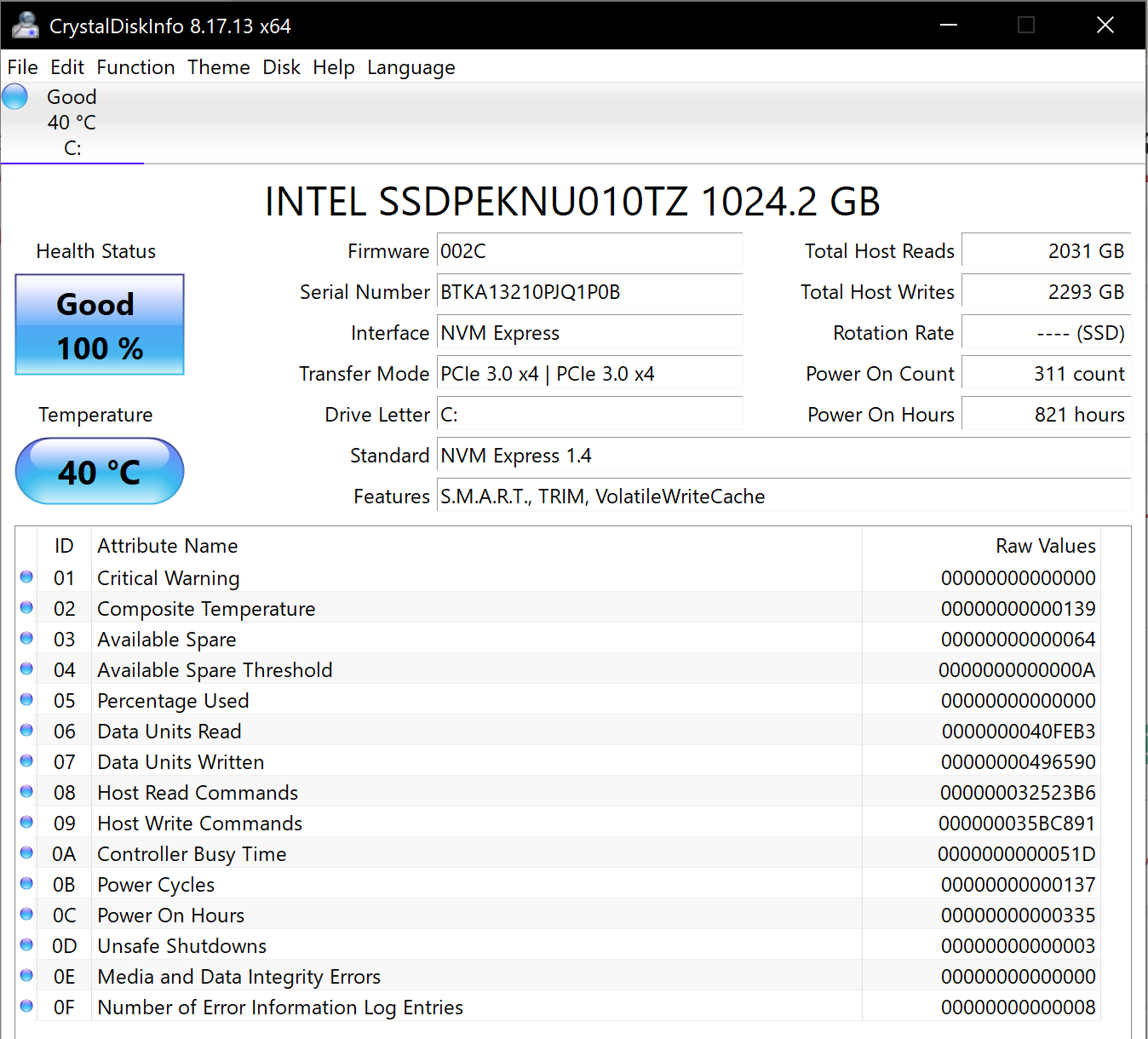

Is there any clue in the SMART report? You could use a tool such as CrystalDiskInfo or GSmartControl.
Here's the results from CrystalDiskInfo:
I also ran the command: wmic diskdrive get status, which said my SSD status was ok

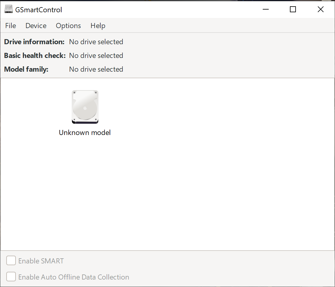

Hm, I downloaded GSmartControl and for some reason, it says my disk is unknown & unsupported
And the output text from clicking on the drive:
smartctl 7.2 2020-12-30 r5155 [x86_64-w64-mingw32-w10-b19044] (sf-7.2-1)
Copyright (C) 2002-20, Bruce Allen, Christian Franke, www.smartmontools.org
=== START OF INFORMATION SECTION ===
Model Number: INTEL SSDPEKNU010TZ
Serial Number: BTKA13210PJQ1P0B
Firmware Version: 002C
PCI Vendor/Subsystem ID: 0x8086
IEEE OUI Identifier: 0x5cd2e4
Controller ID: 1
NVMe Version: 1.4
Number of Namespaces: 1
Namespace 1 Size/Capacity: 1,024,209,543,168 [1.02 TB]
Namespace 1 Formatted LBA Size: 512
Local Time is: Sun Dec 11 15:26:51 2022 EST
Firmware Updates (0x14): 2 Slots, no Reset required
Optional Admin Commands (0x0017): Security Format Frmw_DL Self_Test
Optional NVM Commands (0x005f): Comp Wr_Unc DS_Mngmt Wr_Zero Sav/Sel_Feat Timestmp
Log Page Attributes (0x0f): S/H_per_NS Cmd_Eff_Lg Ext_Get_Lg Telmtry_Lg
Maximum Data Transfer Size: 64 Pages
Warning Comp. Temp. Threshold: 77 Celsius
Critical Comp. Temp. Threshold: 80 Celsius
Supported Power States
St Op Max Active Idle RL RT WL WT Ent_Lat Ex_Lat
0 + 4.00W - - 0 0 0 0 0 0
1 + 3.00W - - 1 1 1 1 0 0
2 + 2.20W - - 2 2 2 2 0 0
3 - 0.0250W - - 3 3 3 3 5000 5000
4 - 0.0040W - - 4 4 4 4 3000 11999
Supported LBA Sizes (NSID 0x1)
Id Fmt Data Metadt Rel_Perf
0 + 512 0 0
=== START OF SMART DATA SECTION ===
SMART overall-health self-assessment test result: PASSED
