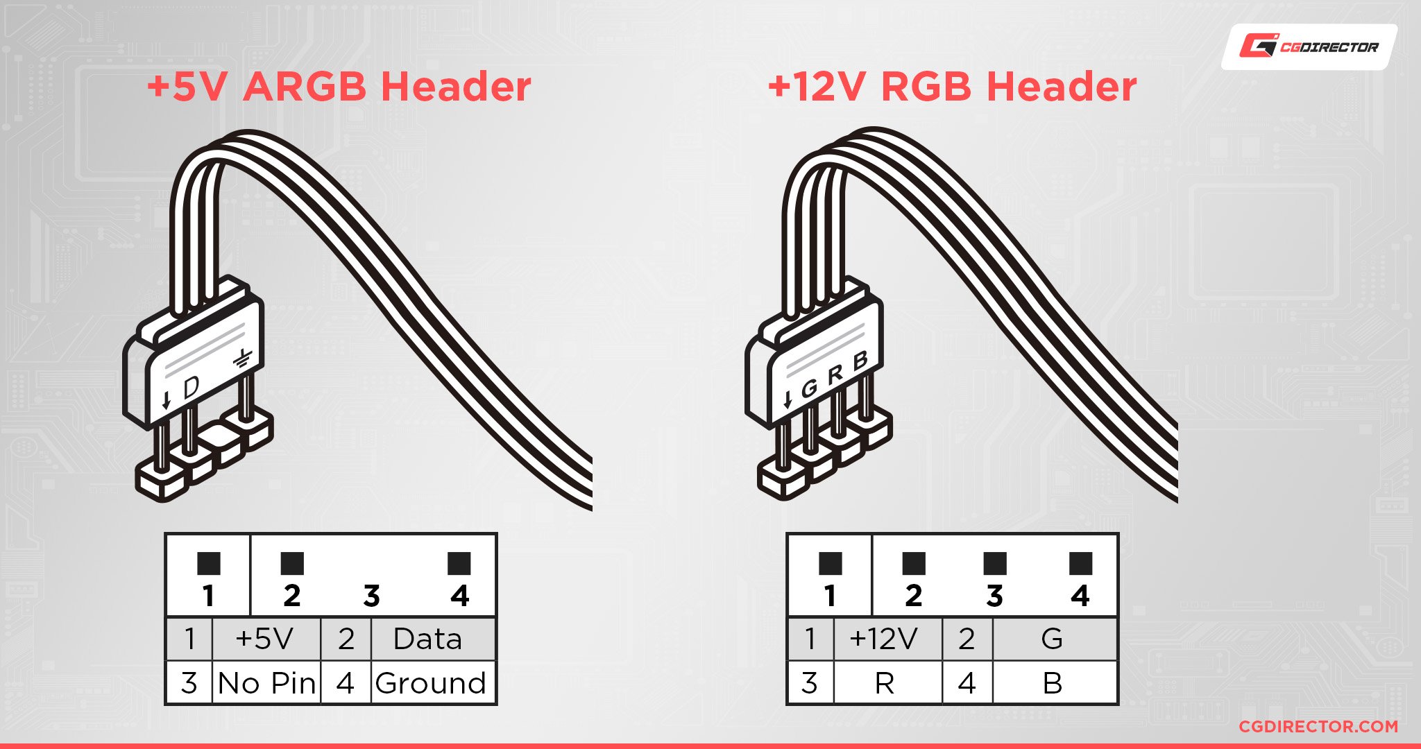

B bobbybinkles123 Aug 29, 2024 16 0 10 Aug 30, 2024 #1 I have got a asus q170m-c for my pc build (it is a budget pc) and i also got a assassin x120 refined SE rgb cpu fan cooler and i have almost installed it but i cannot find where to plug in my rgb cable.

SkyNetRising Titan Jan 4, 2016 32,727 4,820 126,640 Aug 30, 2024 #2 Your motherboard is too old, to have any RGB support. To control RGB on your fan, you'll need a separate RGB controller. Anyway - RGB is not mandatory. Your fan will function perfectly fine with out any illumination also.

B bobbybinkles123 Aug 29, 2024 16 0 10 Aug 30, 2024 #3 what rgb controller would you reccomend for quite cheap?
SkyNetRising Titan Jan 4, 2016 32,727 4,820 126,640 Aug 30, 2024 #4 Any 12V RGB hub would be fine. You said, you have RGB variant. Note - RGB and ARGB are different things. Assassin x120 Refined SE RGB - uses 12V RGB, Assassin x120 Refined SE ARGB - uses 5V ARGB.
