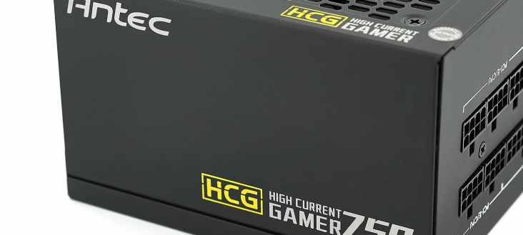

logainofhades
I like gigabyte motherboards, and some GPU's, but their PSU's, not so much. I would go with this Seasonic built Antec, at that wattage .
PCPartPicker Part List
Power Supply: Antec High Current Gamer Gold 750 W 80+ Gold Certified Fully Modular ATX Power Supply ($115.99 @ Newegg)
Total: $115.99
Generated by PCPartPicker 2021-03-08 17:40 EST-0500
Mar 8, 2021
21
15
Total: $115.99
Thank you, I will probably buy this PSU.
