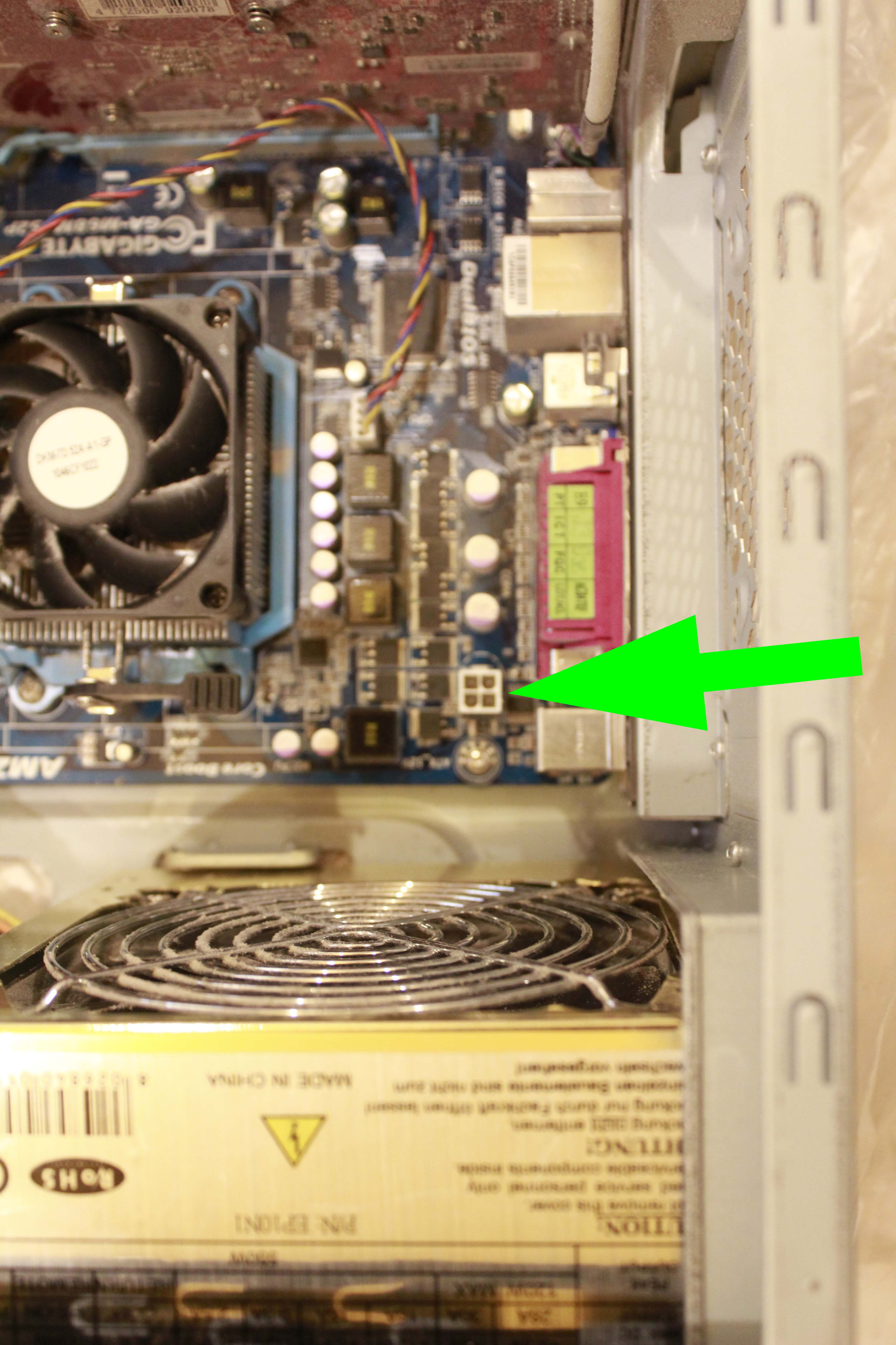

Hi,
I bought an RM1000x PSU by Corsair some years ago, which is a 1000Watt ATx PSU.
I thought ATx was a standard, so I could just use it to replace the PSU of the PC I built in 2010.
fortunately, I decided to replace 1 output power cable at a time from the old 550W PSU, and right with the first power cable I ran into a problem.
The 2010 motherboard has a 2x2 socket, marked with a green arrow in this photo:
where the RM1000x doesnt have a 2x2 output cable. The RM1000x has lots of sockets on it, and lots of double ended cables, which you insert at one end to the RM1000x and at the other end to the motherboard.
I then had to just reinstate the old 550Watt PSU
I thought as ATx is a standard, I could use any ATx power supply with any ATx motherboard.
thanks for any help
Richard
It absolutely does have necessary cables.
2x2 is called 4pin CPU power cable (ATX 12V 4pin). Nobody calls it 2x2.
4pin CPU power plug you can get from 8pin CPU power plug. It can be split into two plugs.

thanks for the prompt reply! I just pull that apart at the middle?
looking at the photo I gave, it looks like the left half of your photo above?
