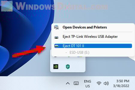

Make sure Fast startup is turned off in windows settings.
When you stop working with removable drives, you have to safely remove them.
If you turn off external drive dock or disconnect it without safely removing it first,
then you can get file system corruption or even partition table corruption.
(unallocated drive indicates damaged/corrupted partition table)

Is simply unplugging the hard drives in that situation considered unsafe?
Yes.
