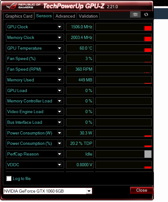

just noticed yesterday my gpu idles now at around 60c or more it justs continually will raise. in past up until yesterday it would hover it the high 30s low 40s
Pc needs to be cleaned but up until yesterday all was fine from what i can tell
https://ibb.co/SXgCP8B screen shot of what its sitting at

im sure this is some dust i need to completly clean the case out not sure where to check the gpu load usage i did a full system scan yesterday with norton and nothing came back up until last night i had never noticed it i attributed by the humidity were having but in no way should it make it jump 20c more
To check the GPU load/usage, use this GPU-Z tool. https://www.techpowerup.com/gpuz/
But since you have already scanned your PC, I'm going to assume all the values are going to show normal. Nonetheless, just check the load/usage if possible. How is the airflow inside your ATX cabinet ? And yes, please clean the GPU fans, and check for any dust as well.

http://gpuz.techpowerup.com/19/06/18/zaf.png
i have 5 fans 3 on front one on top near rear and on on back so it was built to have good airflow not by me of course but i havent had much issues other then this happening i had a buddy setup msi for a fancurve but in past never needed it so im curious as to why now i plan on completly taking side panel off and cleaning on fri for sure cause i havent Done so since last sept only the air filters on the front etc (im bad i know)
