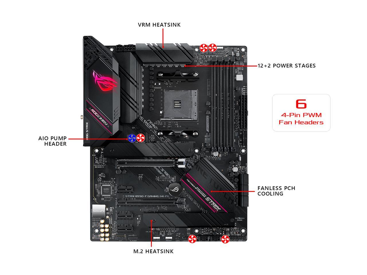

I recently just installed a new motherboard, a Asus B-550-f. When I plugged in my existing AIO pump, ( the Master Cooler ML240R) I plugged the pump header into a AIO pump header on the motherboard. The radiator fans are working fine, but upon closer inspection, my pump header is not working, and my temps are very high (70-80 C when under light loads) I'm wondering if there is anything wrong with my pump, or if I need to plug my header in somewhere else for the cooler to work.

Connect it to another connector. Is it a SATA power or fan? Mine connects to where a fan usually gets its power from.

That's what's strange. I'm plugged into another fan header right now, a CHA fan header, and still no result on my pump working. Should I just try another fan header?

Ok, I do wonder how this is supposed to help my situation. My AIO placement is fine, the issue is that my pump header isn't powering my AIO.

typically you plug the pump into a pump or SYS/CHA fan header - those should supply 2A needed for some pumps. the CPU FAN header can/should power the radiator fan in your situation - otherwise the radiator fan is responsive only to ambient case temps

A pump should be connected to a header that will always be running at 100%. That on a modern motherboard will be labeled pump header or such.
A motherboard detects that a cooler is running by checking the cpu fan header.
It may also check the fan rpm which usually needs to be enough voltage to start. If the bios explicitly or inadvertently sets the voltage at less than 5v. most fans will not start.
cha fan header speeds are variable and not for aio pumps.
Possibly, your pump is defective, but since you have a new motherboard, that is where to look.
