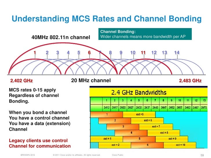

Your AP, to get to 300Mbps most likely runs at a channel width (the size of the bubble) of 40Mhz, meaning to get 300Mbps you need a completely clear spectrum from channel 1-6, or 6-11.
(see image) http://image.slidesharecdn.com/brkewn-3016radiodeisng-111213164144-phpapp01/95/understanding-rf-fundamentals-and-the-radio-design-of-wireless-networks-59-728.jpg?cb=1324564690
Now most likely, you're not able to do any of that because someone living next to you has stupidly put their AP on channel 5 or something.
