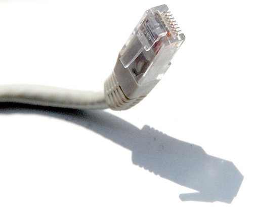

By DSL cables I mean the cables I currently use with my DSL internet, with connector like in this picture:
http://www.b2bnn.com/wp-content/uploads/2014/10/netcable.jpg
That seems to be a standard Cat5e, from the 'router' box to your PC.
