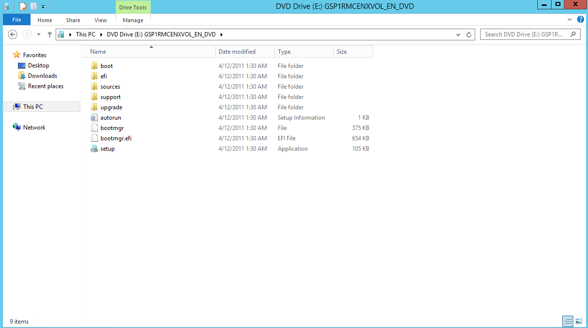

If you have created windows installation media on your USB flash drive, then drive contents would look like this.
Using installation media to install windows does not modify it.
But if you run media creation tool again, then USB flash drive contents will get overwritten.
Thank you! I was a minute too late as the Media Creation just finished and found my files in the drive removed. I can recover them easy.
