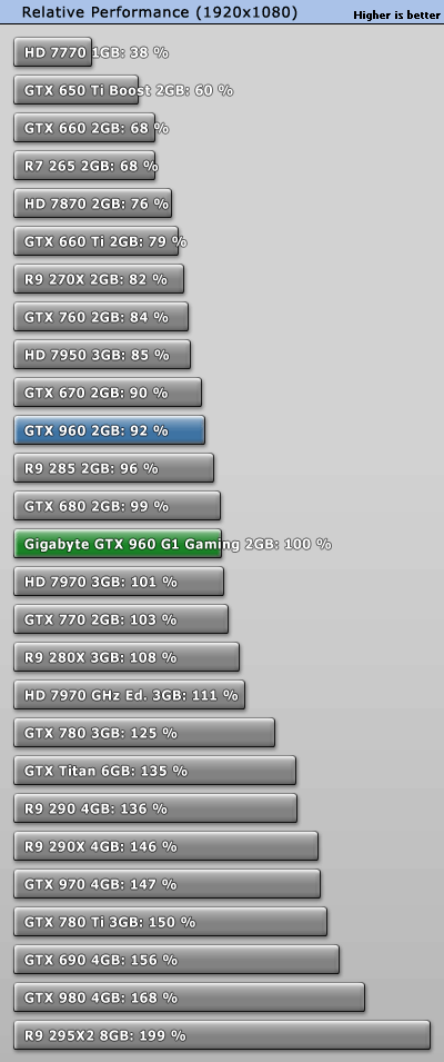

Just a one more question, is this a decent upgrade from the 660 OEM? I don't want to buy this for a 10% increase that I won't even notice.
Casual perusal of benchmarks seems to indicate you'll get about a 50% performance increase with a 960 over a 660. Of course it'll vary with games, and you'll probably get more RAM to load higher resolution textures and crank up anti-aliasing.
