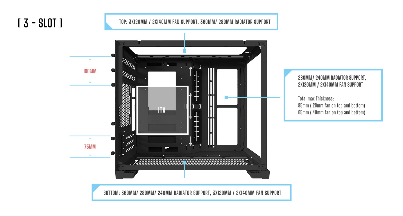

I'm planning to buy EK Nucleus CR360 and I wonder will it fit nicely in the O-11D Mini. Wanted to do a push-pull configuration as well. I'm using an ITX motherboard. I'm abit concerned that the CR360 dimension that is stated on the website is 400 x 124 x 27 mm.

This way, you can fit the rad on top, given that you mount the MoBo on it's lowest spot, giving you 3 PCI slot free for GPU:
Direct link if image doesn't load: https://lian-li.com/wp-content/uploads/2020/11/O11Dmini-3-Slot.jpg
100mm clearance in this situation. Ample for push-pull rad at the top.

Thank you so much for your reply, your explanation clear my confusion! I was worried that it wouldn't fit in as I'm really interested with the AIO. I was using this image instead to measure the rad clearance in the first place which I was skeptical whether it will fit or not.

That image shows GPU clearance. But do note that GPU hooks into PCI bracket, which protrudes into the PC case a bit, thus reducing the length to 395mm. Hence the initial confusion.

Will I able to mount 3 packs of P28 fans (120 X 120 X 28mm) on the bottom of the case with a decent GPU clearance?
If you go with the rad on top, then GPU clearance on the bottom is 75mm.
All these fit, but you won't have enough space free for bottom intake fans.

End result, namely bottom part, would look similar to this:
Direct link if image doesn't load: https://lian-li.com/wp-content/uploads/2020/11/O11D-mini-3slot.png
