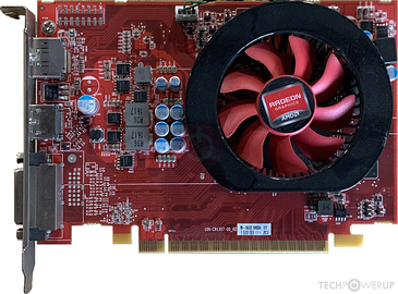

Might I suggest. As long as your Windows is 7/10/or11
Thank you but im running Vista 64 lol
Well kudos for your patience, next year can't come too soon, but honestly even the igpu in Any modern cpu is considerably better than the 8500/8600, whatever you end up with is going to be like moving up from a bicycle to a kawasaki 1000 race motorcycle.
As far as brands go, size isn't a standard. Every brand and copy-cat brand has its own cooler ideas, some even having custom pcb's, so there's simply no saying if one brand will fit and another won't, it's all on the actual model itself. The GT1030 for instance, has 2 fans, or 1 fan or even passive 0 fan models, so will come in different lengths accordingly, which even then may be different to another brands vision of 2 or 1 or 0 fans.
So just like with mITX builds, it's often about shopping for actual dimension, not just ability. I don't know of anyone who would object to a Noctua NH-D15 or 360mm aio on their cpu, but case dimensions often preclude such large cooler use. So instead they have to settle for the best ability they can get, that somewhat fits in the budget, but also fits in the case.
If your case is that dimensionally challenged, then maybe the AMD cards suggested by @Unolocogringo would be a better option, they are backwards compatible with Vista, especially considering Vista and Win7 are essentially the same code and use many of the same drivers. It opens up extra driver choices since Vista is often not on the 'supported' listing for driver/apps choice, but Win7x86 and Win7x64 often are.
