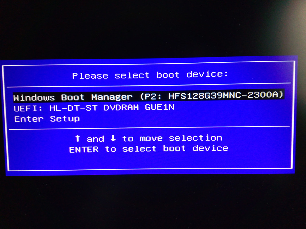

Good evening, I have not been idle waiting for a miracle to happen but, while playing around, I discovered that I could reach my BIOS also when tapping Esc rather than the usual F2 during start up. The screen is however slightly different. I also tried to boot from a dvd with the Linux Mint 19 iso and from a Windows 10 recovery dvd. They both booted normally when I pressed the DVDRAM choice. This choice does not show up when I use the F2 route, even with the dvd's in the tray.
- link: https://i.postimg.cc/B6QcQ4dw/IMG-20181017-165417.jpg
So this "may" be a possible work-around. I'm still trying to create additional boot entries in the full blown BIOS sofar without succes. I will comment some more when I have time to do further testing.
