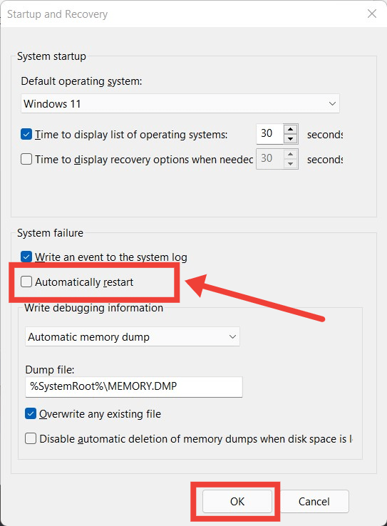

Now it doesnt freeze but just restarts on its own. Sometimes it'll show a bsod for a split second but I cant read the error.
Turn off auto-restart on system failure in settings.
Then you'll be able to read info from BSOD.

Thanks, that worked. The Stop code is: CRITICAL PROCESS DIED
