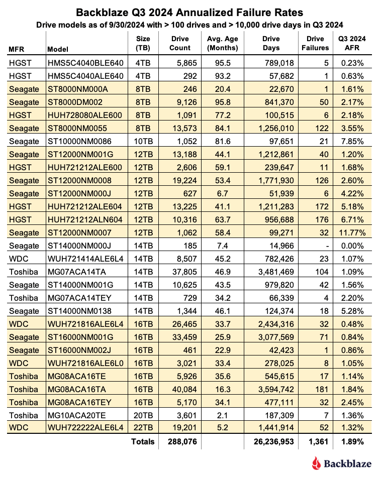

I was considering factory refurbished 12TB Seagate drives advertised on Amazon at a very attractive price, but decided against buying after reading various blogs and checking the Backblaze statistics.
https://www.reddit.com/r/DataHoarder/comments/s7i5bc/fyi_some_anecdotes_indicate_that_12tb_seagate/
The model in question was the ST12000NM007, with a failure rate of 11.77% (half way down the list).
https://www.backblaze.com/blog/backblaze-drive-stats-for-q3-2024/
Now it's possible Backblaze may have purchased batches of bad drives, or Seagate may have issued a firmware update to address unreliability issues, but it put me off buying this particular 12TB model. I was considering 8 x 12TB in a TrueNAS RAID-Z2 server for 72TB effective storage.
It might be worth locating your drive in the Backblaze data to see if it's supposedly reliable or not. A few Seagate drives have a 14% failure rate at Backblaze. You might need to download several 1GB files to find your drive, but it's probably there.
https://www.backblaze.com/cloud-storage/resources/hard-drive-test-data
Sorry I can't be more optimistic, but if your 24TB drive features in Backblaze data at over 5% failure rate, I'd be inclined to exchange it for a different brand or model.
