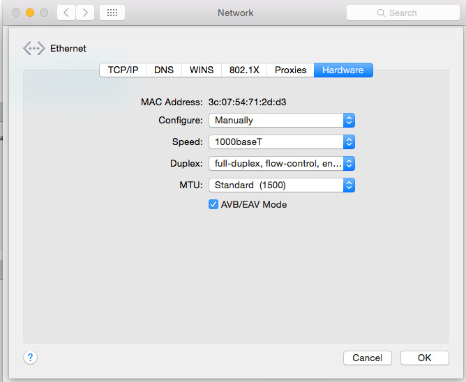

Yes the same location. Wired card is Broadcom 57765-B0. When I bootcamp in windows and use the wired connection it says at connection 1mbps. Shouldn't that be around 100 or something?
Just turned flow control off and it didn't increase or decrease the download/upload speed unfortunately...
