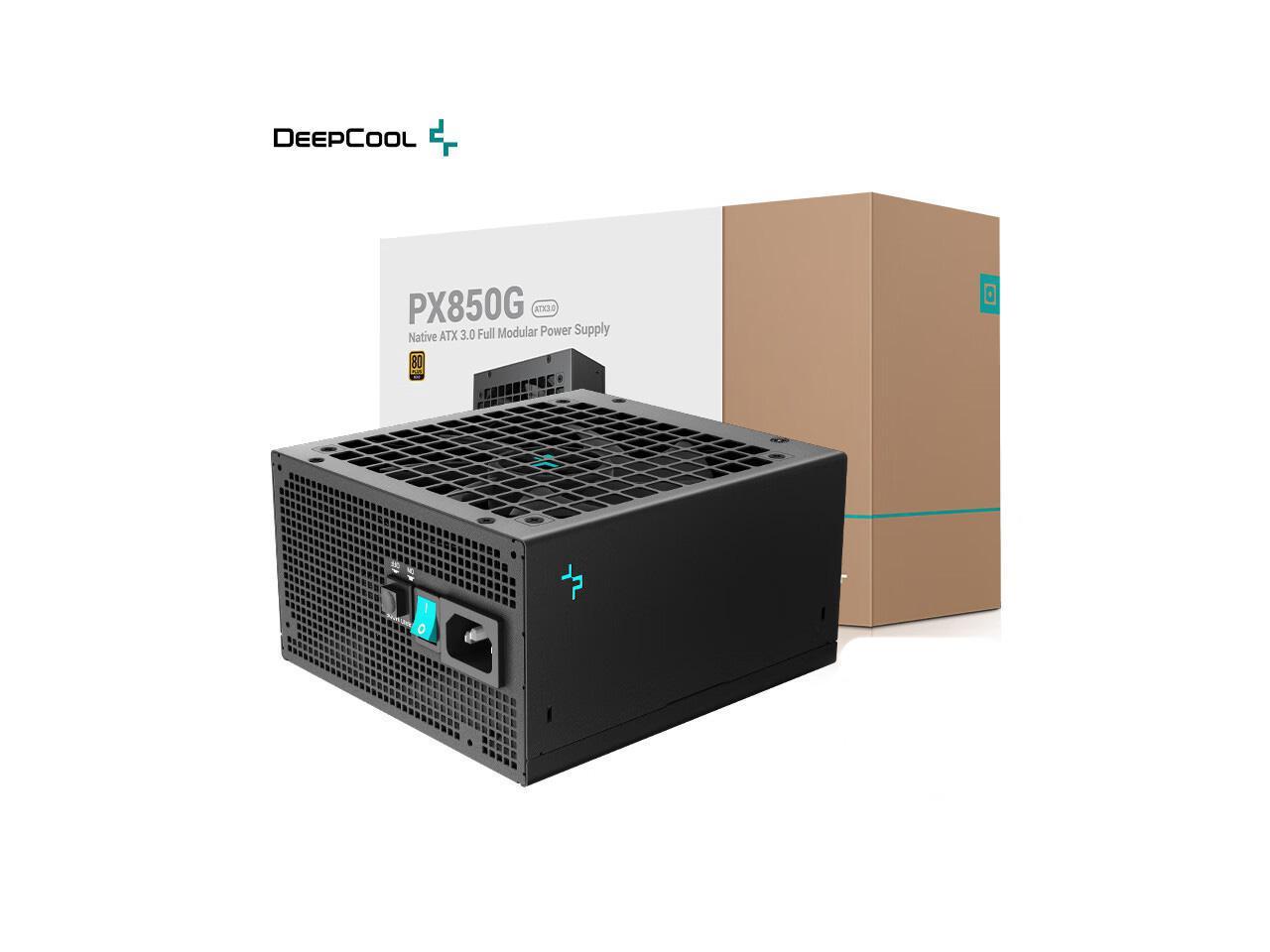

I would have thought that you might have saved an extra 100 quid for a new PSU by now.
For long term, i would suggest going for the 7900GRE and any of the 850W PSU listed above.
