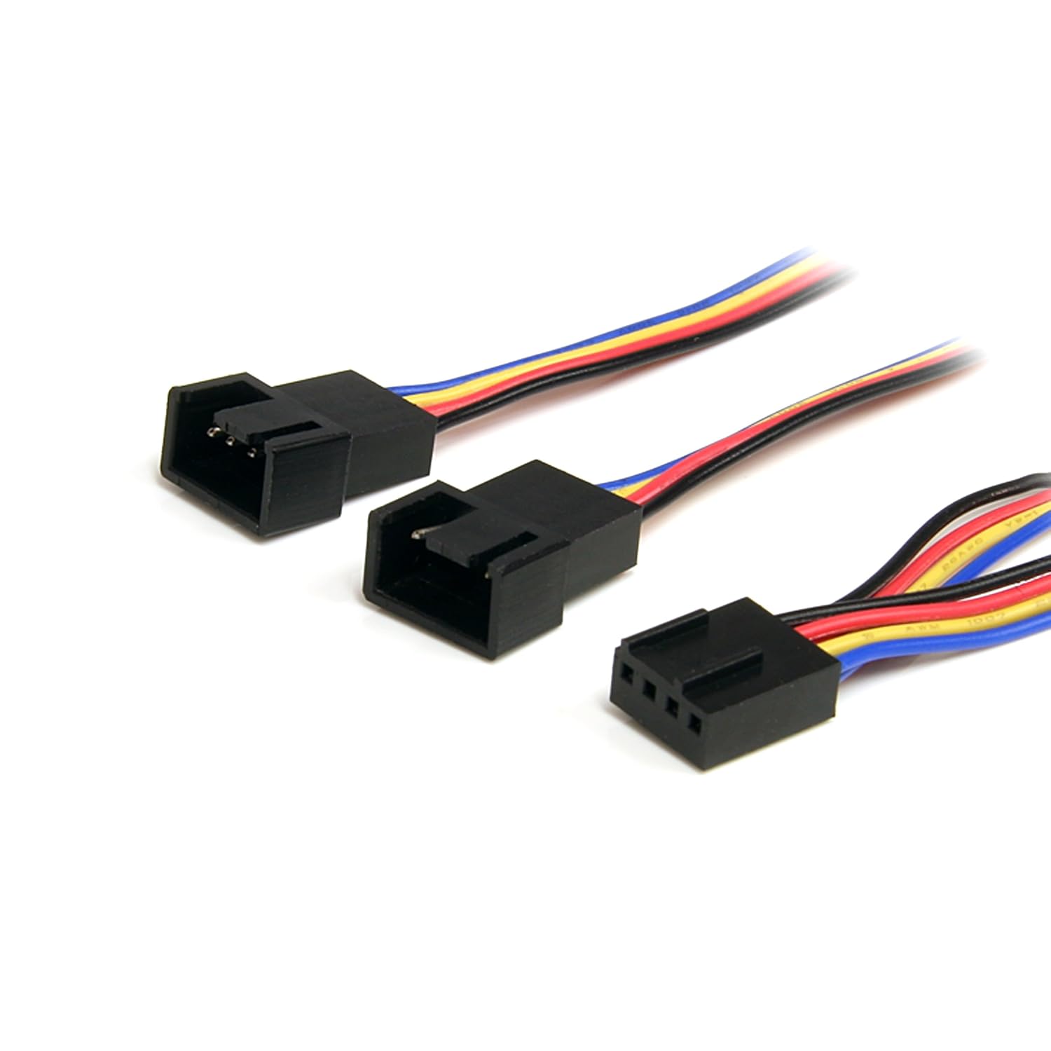

would a 4 pin fan splitter still work if its missing one pin ?

i recently purchased a 4 pin fan splitter on ebay. in one of the sockets, a pin is missing so thers only 3 pins. Would it still work if i plug a 4 pin fan in there. Also, when using a 4 pin fan splitter for cpu fans (h60 water cooler), would it affect the performance of each fan or is there any limitations using a fan splitter. thanks in advance
Soulds like your are talking about a PWM fan splitter cable.
A PWM fan uses 4 wires; fan speed signal, PWM signal, 12V & 0V.
The splitter will have 4 wires that attach to the first fan and 3 for the 2nd fan. This is because the motherboard can only monitor one fan and will then use that reading to control both fans accordingly via the PWM signal.
its not a molex one. this is the one below, it connect to the motherboard but on one of the adapters there are only 3 pins and the other has 4 pin. i will be using these for the two fans on a h60 water cooler. what do i do :s ?
