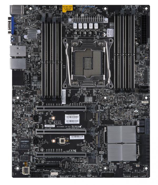

So I am building a new workstation to run engineering simulations. I am getting repeated BSODs on the system after installing the graphics drivers (Both AMD and NVIDIA cards tested).
Specs:
Motherboard: Supermicro X11SRA-RF
CPU: Intel Xeon W 2195
Memory: 512 GB Nemix (64 GB sticks) RDIMM 2666
Graphics Card: AMD Radeon Pro WX 9100
PSU: Corsair HX1200i
I first individually verified each ram stick and have narrowed down the crashing to be only after a graphics driver has been installed and the computer has been restarted. The most interesting bit seems to be that when I install the driver the card is then recognized in hardware manager and benchmarks correctly but on the next reboot it starts to BSOD again.
It consistently crashes just a few minutes after a few minutes only giving me "Critical Process Has Died"
I am completely out of ideas so any suggestions would be much appreciated.
-Rylee
I updated the BIOS and SuperMicro couldn't pinpoint a problem.
After several days I was finally able to narrow it down to the Intel M.2 that I had initially ruled out because I had tried two different units. Turns out both M.2s were both just becoming unreachable by the system causing windows to crash. This is true for a total of 4 units that we received.
