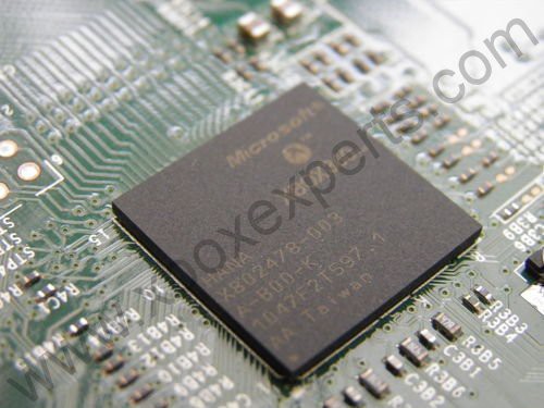

as jay_nar has suggested try the composite plug first and see if you get picture that way. if that still fails it could be the Hanna chip, it could also possibly be the GPU, heck could even be the cpu, who knows without an error code (even with error codes it still sometimes is not specific)
being that the consoles is 4 years it could be on it's way to killing itself.
I have worked on plenty of no video consoles and in most cases it just needs a reflow and it will be good to go.
