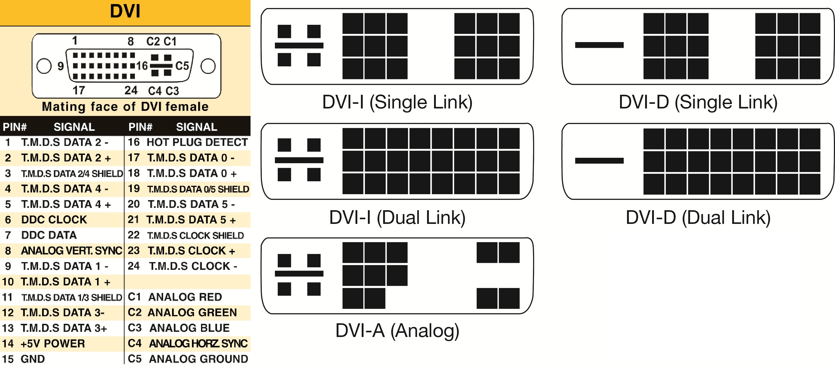

If you use DVI be sure to use the digital one and dont force the connector in. (DVI-D will do good)
