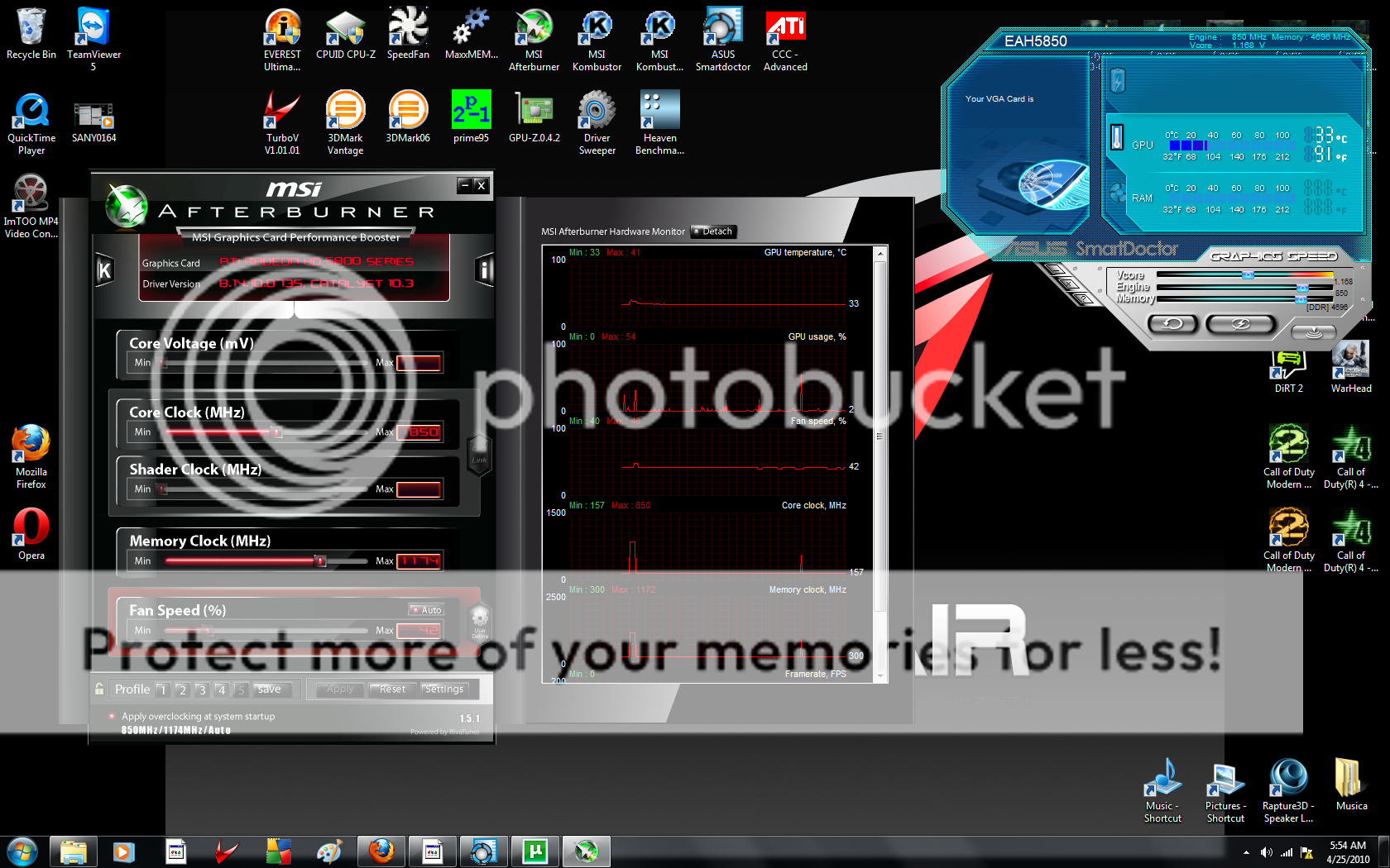

Check out these temps after a quick BC2 session :
Maxed out the OC in Doctor (amazing temps) :
Amazing how I got it to 1.2v and still get a ridiculous idle :
Room currently at 71F [:lectrocrew:6]
Right now I have my Sapphire 5850 OCed to 1.174V, 875/1225. I have had it up to about 1250 which made a few more frames but I can't keep it stable. I'm using MSI Afterburner, quite a good app imo. It hasn't gone over 78C with 40% fan (to keep it fairly quiet).
From the testing I've done with different settings, a high clock isn't going to do anything if the memory can't keep up. After about 850 I only was seeing a noticeably FPS increase from memory but the memory seems to also destabilize it faster. I'll run a few tests and then on the 3rd or 4th at the same settings it crashes (like a 1250 mem).
Any tips? I've raised the volts up to 1200 even 1225 but it still crashed - maybe even faster! lol. Can't really say for certain I think I've pretty much hit the limit of this card tho.

Hmm I found I was getting greyscreen if I went much over 1225 mem speed. I tested as high as 1250 but it just greyscreend sooner. I put the voltage up to 1.3V just to make sure that wasn't the problem, and temps never got into 80s, but yea after a couple tests it would greyscreen. Right now I have it at 950/1220 I think. I was using MSI Kombuster with MSI Afterburner. I played Crysis after I got it somewhat stable on Kombuster and after about 20 mins it crashed so I lowered the gpu speed a bit and then it was fine for about 45mins but ended up crashing again. I don't know how you got it so high and stable... Is there mobo settings you changed? I tried upping the PCI voltage amplitude thing from 800mV to 1000mV and it seemed to add a little stability but maybe not. Otherwise I heard a little more VTT voltage can help but I'm not sure, I upped it by .1 and .2 but I still had greyscreens when testing so I just put it back to normal.
This aint easy.. I have to use AB for the OC and Doctor for the voltage. Kombustor is stable @ 1000/1245, anything over 1050/1275 is unstable. I still need to update the Bios on my board as well.
The fan curve has been fixed and now temps stay in the 57/58c arena at LOAD :
