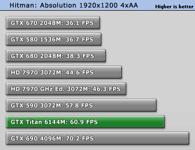

And 7970 GHz is even better at higher resolutions.
Nice try, nvidia troll.
