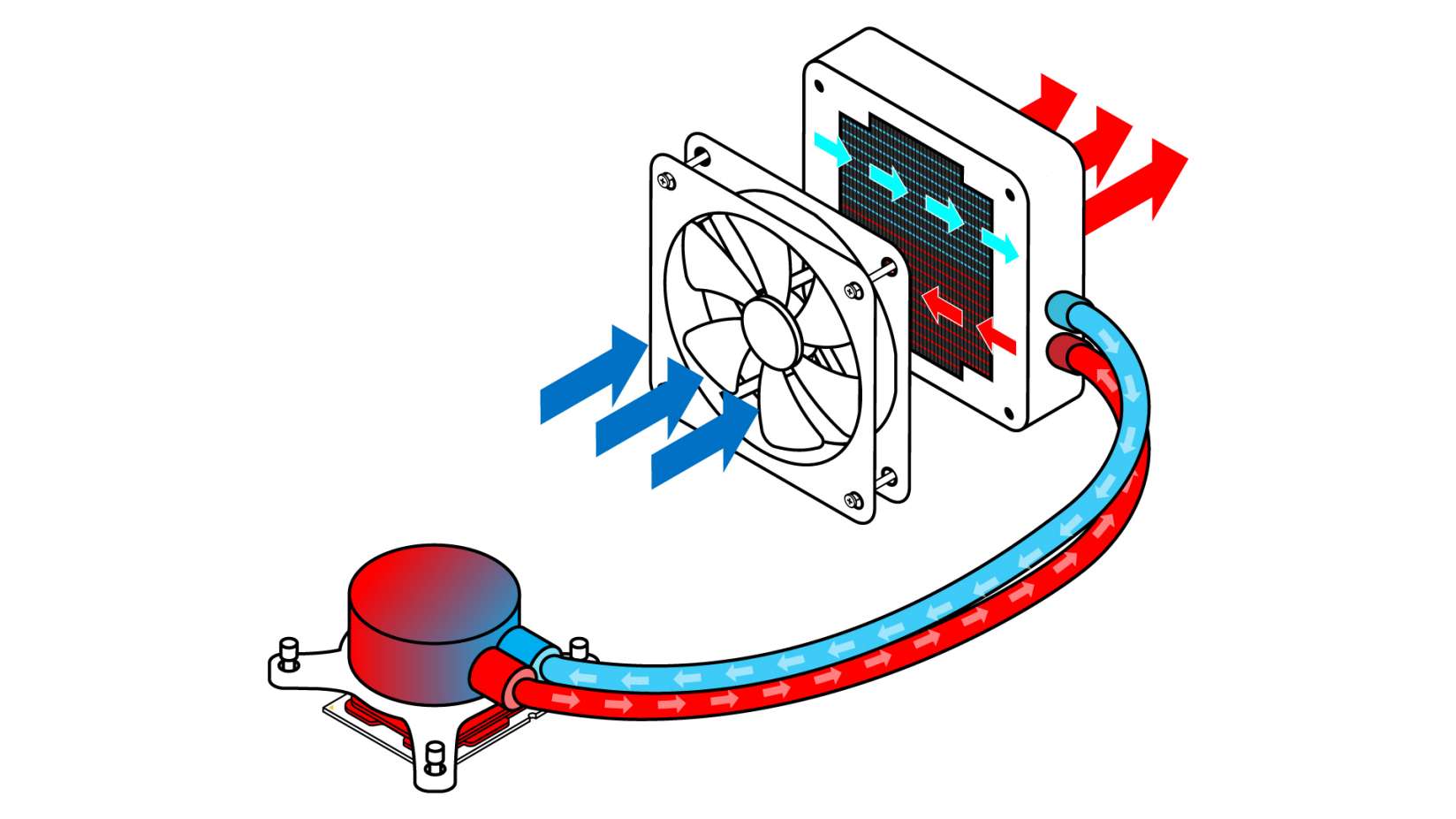

Quick question on AIO coolers. In my own mind I have the answer from research, and having an AIO in my current gaming system.
It's my understanding that when an AIO is functioning correctly, there should be one warm pipe, and one cold/cooler one. This makes sense to me. As the coolant absorbs the heat from the CPU it travels to the rad, heat is expelled, coolant (colder) goes back to CPU, rinse repeat. Is this right?
I've offered this advice on a few threads only to be told that, no, both pipes should be warm. So I'm trying to figure out if that's the case. Every resource I've looked at says the same thing:

Thanks for the reply. Yes, I've linked that one in my thread. That's why I was wondering. It really suggests it's cooler. But as @USAFRet said, the difference seems minimal. I wonder is that 0.2c variance enough to re-absorb heat and remain efficient.
Yes.
The tube FROM the CPU to the RAD is wamer, but not so you'd notice.
Equilibrium.
1.2C difference in the skin temp of the pipes.
0.5C
Equal
Measured with these devices:
https://www.amazon.com/gp/product/B01H1RDJOI
Bottom line - If there is a noticeable temp difference, something in the circuit has failed.
Actually, not really. Not so you tell by hand.
Generally, the liquid is moving through the system fast enough it reaches equilibrium.
I've tested this with a Cryorig A80.
2x USB powered thermometer probes, reading the skin temp of each tube.
Under light load, there was at most maybe 0.2C difference between Supply and Return.
Under heavy load (Prime95 or similar), maybe a 3-4C difference, until it too eventually stabilizes.

Thanks for the reply. So, would that stand too in the case of a failing AIO?
Yes.
Equilibrium.
0.5C
Equal
Reactions: Roland Of Gilead
Yes.
Equilibrium.
0.5C
Equal
Okay, understood. Thanks for that.
Was wondering how to put it to other forum questions, in terms of when it's failing, so now I know how it should operate normally, and with very little variance, my advice might be more accurate.
